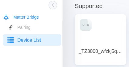

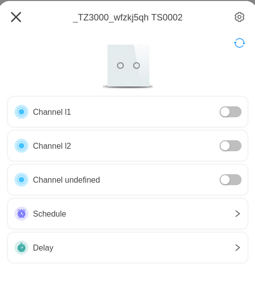

Hello iHost Development Team,
First of all, I want to give praise to the development team. I think the iHost system is absolutely fantastic. I’ve had the device running since its release march/2023 and am always excited about new updates. :grinning:
The Problem:
After the last update to version 2.3.0, some Zigbee devices no longer work with Alexa with Matter .While they appear in the iHost support list, they cannot be controlled via the Matter protocol with Alexa. Additionally, an extra button has been added to these devices, which doesn’t have any function.
In version 2.2.0, it was still working. I removed the devices and repeated the Matter pairing process entirely, but unfortunately, without success.
Zigbee Devices with erro:
Manufacturer: TZ3000_wfzkj5qh (Avatto)
Model: TS0002
Manufacturer: TZ3000_skoh4qcn
Model: TS0002
Manufacturer: TZ3000_ywubfuvt (Zemismart)
Model: TS0002
I hope this will be corrected in the next update. :slightly_smiling_face:

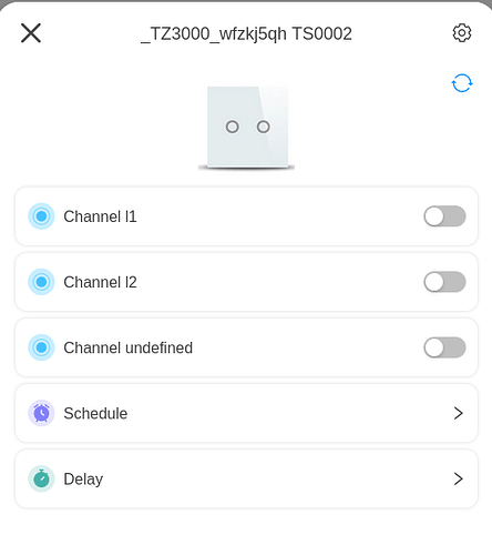

Hello,
Version B. I tried the following:
  1. deleted the switches mentioned in iHost and Alexa and then re-integrated them. Without success
  2. Reset the switches mentioned and then re-integrate them. Without success.
  3. Matter in the iHost and all devices in the Alexa app deleted and then re-paired everything. Without success
These are Zigbee light switches with and without a socket. These function normally in the iHost and are displayed in the Matter connection at iHost and in the Alexa app. However, the control via the Alexa app/manually or by voice no longer works. As I said, the whole thing still worked perfectly with version 2.2.0.
Since these are only a few devices, as an emergency solution I generated virtual switches using a red node, which can then be controlled via the iHost/Matter via voice control in the Alexa app.
What I also noticed now is that the entire energy history (Energy Overview) of all Zigbee sockets was deleted after the update to 2.3.0 and is no longer displayed.
Manufacturer: eWeLink
Model: CK-BL702-SWP-01(7020).
