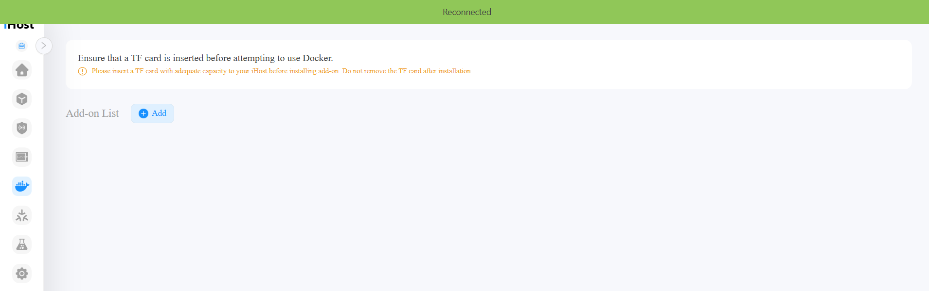

Will do print screens when this will happen again.
First when this is happening it looks like iHost docker lost ewelink app because docker looks empty.
Second… there is I can’t remember the exact color (green or blue) bar at the top of the screen
saying disconnecting… and then reconnecting… in loop

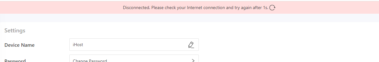

Is the disconnecting and reconnecting bar looks like this?
Different color and is visible only when opening Docker tab

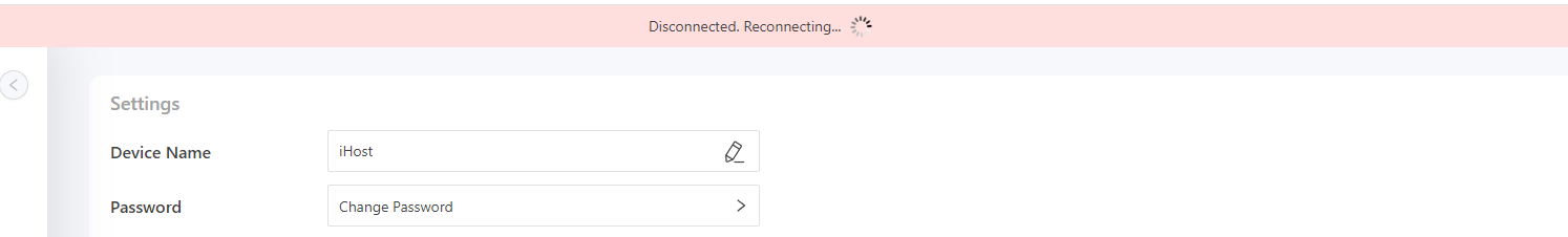

Maybe you mean this color?
maybe… can’t remember as I panic that docker data are gone and did iHost restart
But this is showing only in Docker tab
Also… when this is happening… Docker is empty… ewelink app is gone

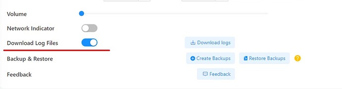

The log you provided can’t pinpoint the problem because the system log button is off when the issue happened.
Please keep it on.
If the problem happens again, let us know.
This one… ?
Yes.
Keep it on and it’ll record the problem.

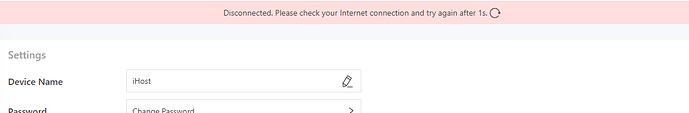

I experienced the issue you mentioned: the content of he docker page disappeared (empty) and every time I open the page keeps connecting and disconnecting:
