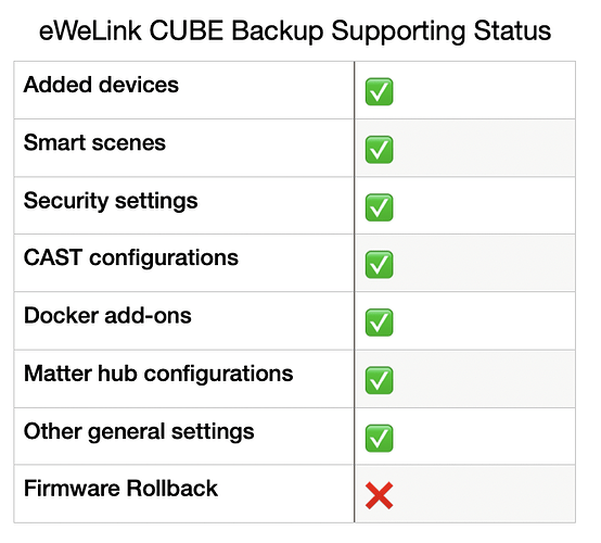

Please kindly check the release log and an explainer:

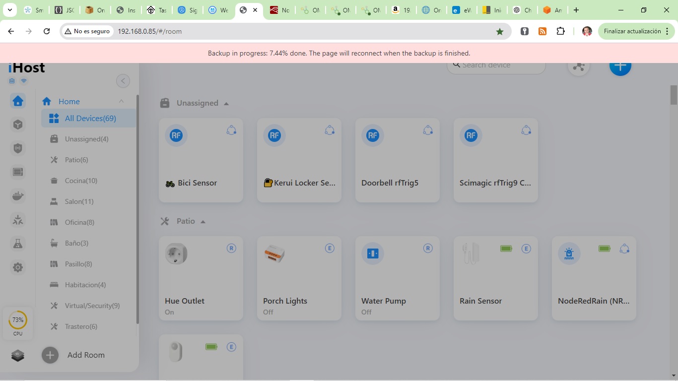

Updated, everything seemed OK. Tried Backup (I already have support ticket 219927 open with Eric on this problem as it didn´t work) but again showed message “Backup failed”.
Then I get this error (see top of image), unable to do anything as everthing is greyed out and all 70 devices bridged to Smartthings offline…
Waited 15-20 minutes, bridged devices came back online, Node-red addon running but no web UI, cpu 99-100%…then after 5 minutes came back online. Have a 232Mb backup, :+1: although all a bit hair -raising!
That is a big backup. Mine is 147MB and I thought I had quite a lot of devices.
The system will “frozen” during the backup procedure and with a prompt on the top to show the processing, it’s not a error, and will be back after the “backup file” is created and stored properly.
BTW, 232M, that’s a big one.
Why could that be? I have 70 devices (around 15 LAN, rest Zigbee, no Matter ), 2 scenes, no Cast, Matter bridged to Smartthings and iPhone.
Nothing unusual, just surprised—this is the largest backup I’ve seen so far.
OK. Only presumably being a large backup it timed out and showed the “Backup Failed” error when it was still in process (15-20 minutes)

Oh, sorry, I missed the “Backup failed” part which haven’t shown in previous screenshot.
It should not be promp out during the backup procedure if it’s still in progress, and your guess is right, it’s may due to a time our between the front-end and the back-end.
We will try to investigate deeper to see what exactly happens.
