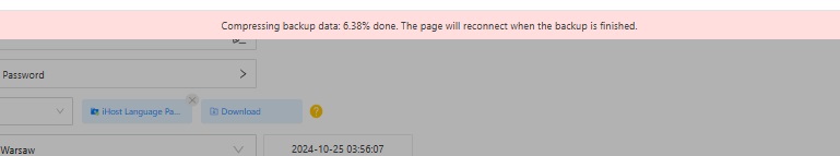

I installed version 2.3.2 but still can’t create a backup.
edit:
I suspect this is a Backup Space Limit bug!
[2024-10-24T23:12:49.919Z] [INFO] default -e[39m [OperationManager] - startBackupOperation backupFilesSize:17600290560 - backupSpaceSize:1610559488
e[32m[2024-10-24T23:12:49.920Z] [INFO] default -e[39m [OperationManager] - startBackupOperation backup Space Limit!
After uninstalling home assistant and homebridge, the backup was successfully made. :frowning:
The backup file is 346 MB in size.
And here the question arises: what sense does this make? :thinking:
The backup took 10 minutes. The pink progress bar froze at 6.38% and did not change until the end of the process.

I managed to get a backup of 1.08 GB done with 2.3.2 and get it downloaded. Having homeassistant docker installed as well. If I understood it correctly these backups are stored in the internal eMMC chip. Not sure what else can there be there that would reduce your free space.
It calculates the backup size before preceeds, which has a limit of 1.5GB

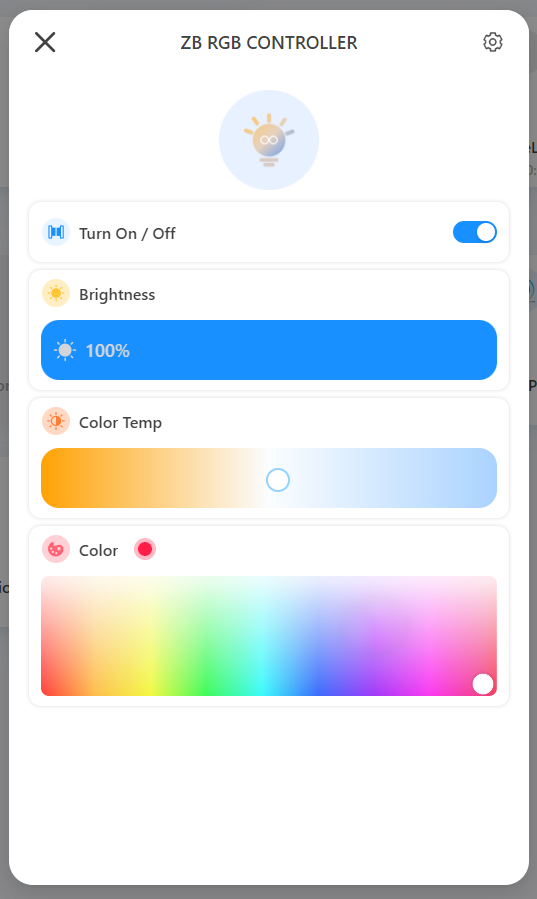

Hi, updated to 2.3.2 and still see disrepancies with the RGB color picker. I am using ZLD-RCW Zigbee RGB controller from MOES Moes RGB+CCT LED Controller 12-24V ZLD-RCW Zigbee compatibility
Basically can not choose pure colors (like red, green or blue), all colors show washed. Instead of pure red, I got pink.
When picking color in the right lower corner of the picker this is what I get in nodered as status:
{“power”:{“powerState”:“on”,“updated_at”:1729851219198},“color-temperature”:{“colorTemperature”:52,“updated_at”:1729851220737},“color-rgb”:{“red”:255,“green”:28,“blue”:70,“updated_at”:1729851226665},“brightness”:{“brightness”:100,“updated_at”:1729851220355}}
Thanks for feedback, it’s a known issue we are working on, check the release explainer for V2.3.2 here,
