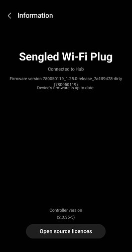

i tried sengled plug because it was working before , also I tried zigbee matterbridge , those two were working very well before .
Today i upgrade app to 5.7 and nspanel to 3.2.0 , still unable to add any matter devices
