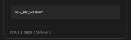

  1. In the card of the selected device, click the three vertical dots next to “RECONFIGURE” and choose Manage Zigbee Device.
  2. Then proceed as shown in the screenshot. Adjust Query Jitter Slider In the debug window, locate the Query_jitter slider.
    :warning: Make sure it is set to any value above 0 — this helps prevent timing issues.
  3. Click ISSUE ZIGBEE COMMAND — even if it appears greyed out and seems inactive. After a moment, it will turn green with a check mark confirming the action was successful.
    Close the card and return to the device screen. When you click the Firmware entity, you should see the indication of the installed and potentially available firmware version for the selected device.
You’ll also see a note that says: “If you are having issues updating a specific device, make sure that you’ve eliminated common environmental issues that could be affecting network reliability. OTA updates require a reliable network.”
As you can see in the attached screenshot, the installed firmware version is higher than the available one — an interesting quirk in itself :smiling_face_with_sunglasses:

You have given me new hope. My yam zha settings already had the ota setup but I was unaware of the Query_jitter slider. One new step to try.
I will give that a try and see if it impacts the timeout error I get when the update is proceeding.
Thanks soooo much.
This is not a permanent solution. It works on a one-off basis, and if you want to trigger a check, it must be repeated each time. ZHA does not stay in a constant checking state. Keep that in mind before getting too swept up in enthusiasm.
I did try it once but the device still times out. However it gives me a new avenue to follow to try and get this working.
Its also good to know that it not does retain those settings. I have no idea what all those options do. Is there any documentation on those that I could read to help me get a better understanding?
Its a little tedious and time consuming using trial and error trying to figure out what the different things do.
Thanks again for your help
I truly don’t mean to sound dismissive, but all of this information is quite easily searchable or you could even have an AI neatly break it down in a clear and approachable way. Honestly, you’d have it sorted in minutes. Will you? :slight_smile:
Thanks, I’ll do some more searches. So far I haven’t found anything but I wasn’t looking for info related to this area. I had seen this dialog previously in my tries but I never tried to make any changes since there was no info connected to any of the fields and I couldn’t remember how to get into those dialogs from the main screens. Now that I know how to get there I can start looking the specific things up.
That greyed out button is certainly not very intuitive. I would have just ignored it if you hadn’t pointed it out.
