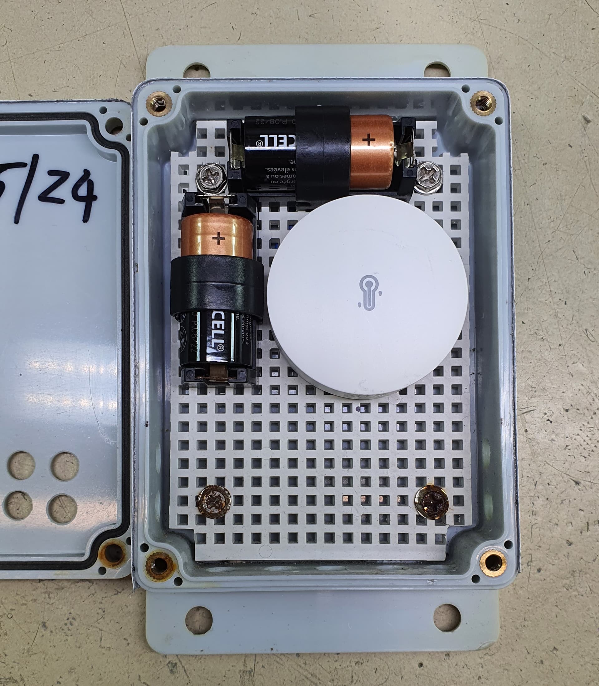

I’m happy user of multiple SNZB-02P - temperature and humidity sensors.
SNZB-02P are connected to 2 x Sonoff ZB Bridge Ultra.
Few of my SNZB-02P are working outside in boxes like the one on the picture.
I upgraded power supply a bit :wink:
Box is sealed from top and sides - but have plenty of large holes at the lower part from 3 sides.
It is a huge pain to go there and open them just to push the button to do FW update.
I did it this time… couldn’t find better option.
But… maybe someone know trick for the future

if someone is interested with battery life - this one was installed in May 2024 and battery is still showing 100%
my guess is that my power supply can keep it running for a few years - but FW update is huge pain
PS 2
This is upgrade of my previous project - the same boxes - but in the past I used older Sonoff ZB temp and humid sensor - the square one and only 1 battery. Battery last for over 1 year.

Judging by the capacity, your setup won’t really last much longer than usual. But hey, it looks fierce and professional :+1:t2:

I don’t drink coffee :wink: and tried few tricks before. So far only pushing the button did the job.
Why wanted do update quickly… because one of SNZB-02P stopped sending data after got notification that new update is ready.
So pushing the button solved the problem - after update - SNZB-02P started sending data again.
Also that new firmware for SNZB-02P - I think it improve the way and make that device more reliable in terms of sending data to ZB hub.

SNZB-02P on CR2477 3V 1000 mAh - declared by Sonoff up to 4 years of work - but in room temperature - this device is designed to be use indoor.
Working outdoor is changing a lot. First - more temp and humidity changes - result more often data are being send to the hub.
Second - Winter factor.
My project SNZB-02P on 2 x CR123A which is 2 x 1500 mAh = 3000 mAh
and my device works outdoor that include WINTER !
So far this device survived one winter and another is coming.
Now according to Sonoff data - this device working indoor on standard battery should survive 4 years on 1000 mAh battery. On 3000 mAh battery it may be double or more.
But outdoor factor will consume more drain for sending data more often and mentioned earlier winter factor.
As mentioned - this particular device was installed in May 2024 and now is September 2025
this is already 15 months with ZERO impact on the battery - still showing 100%
So my guess is that it may last another 15 months or more.
I would not be surprised if it would last 36 months and that include 3 winters

But just got idea for mk3 version of my project
bit bigger box, smaller holes but more of them - this should solve spiders nests inside the box
then everything else like on the picture
with one upgrade - I will add button, waterproof NO button pointed down - in area under left side battery - then will be able push it without removing and opening that box - just using plastic rod
