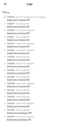

I have a problem with scenes, after clicking the button on r5 the light turns on and immediately turns off and vice versa, when turned on sometimes they immediately turn off and on again. After clicking again the light turns on/off as it should. The situation repeats from time to time. The set scene is “reversed” (when turned on turn off, when turned off turn on) Do you have any solution

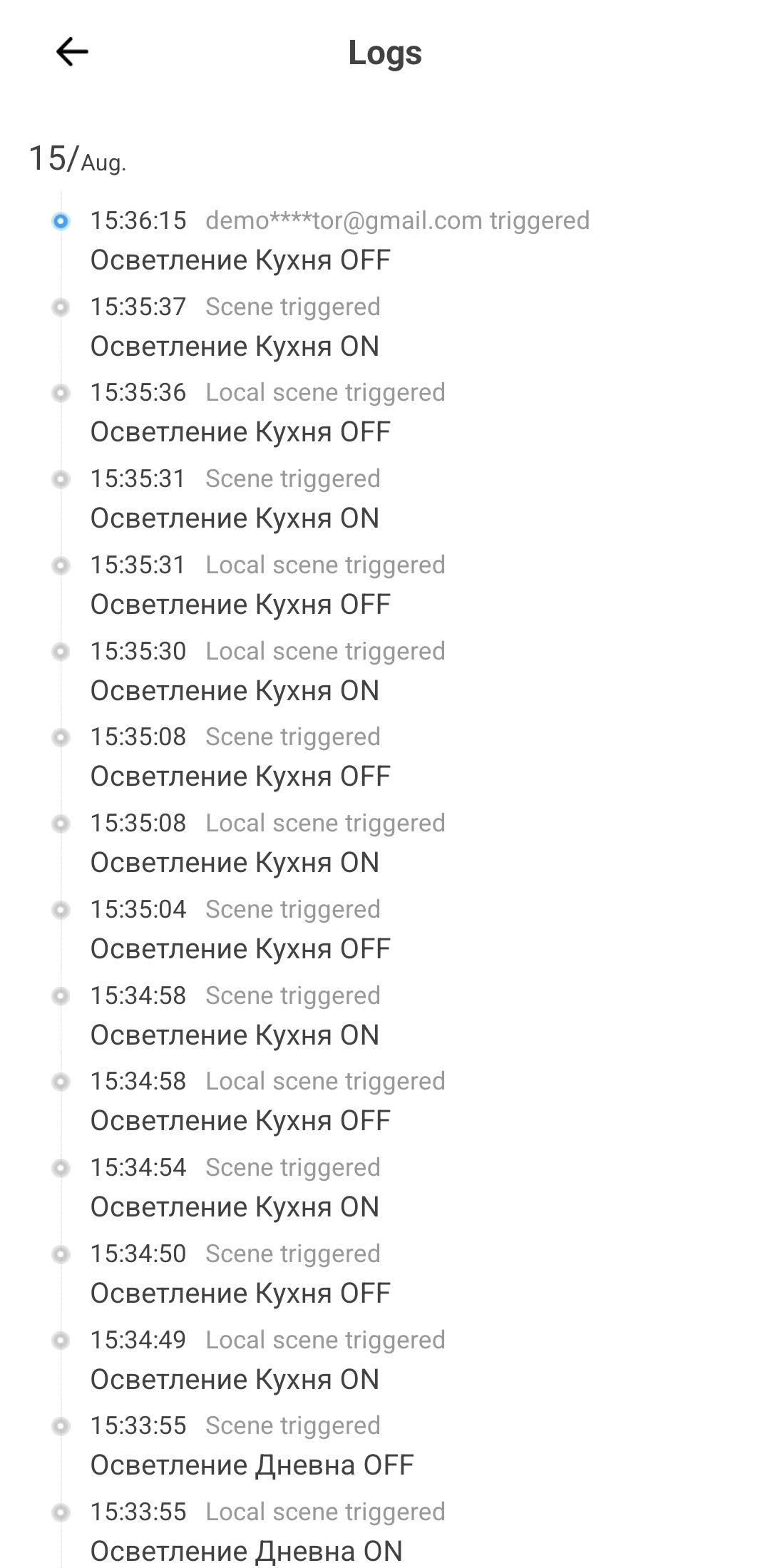

I have the same problem. For some reason, the R5 triggers twice on button clicks - from what I see, once as a Local Scene, once as a Scene. Interestingly enough, trigering via HA+SonoffLAN works perfect.
