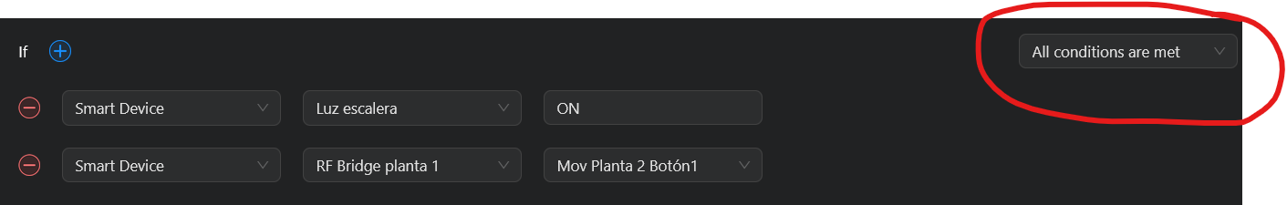

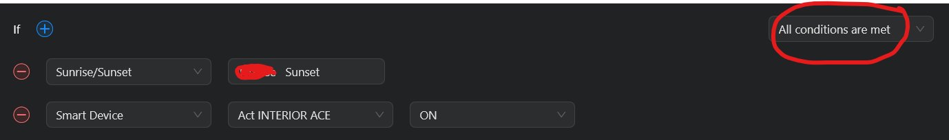

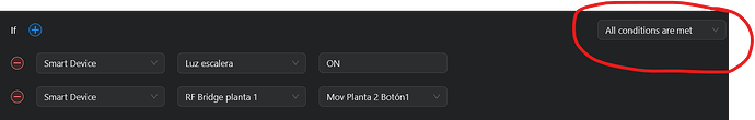

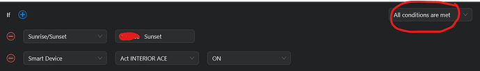

I can see sometimes scenes does not work as should be:
Today, for example Act. INTERIOR ACE ( a virtual switch) was OFF but scene RAN
And this scene does not work. This scene turns ON between 0:00 and 1:00. Luz escalera is a SONOFF S60 and is ON. Mov Planta2 Botón 1 is a PIR sensor that goes to RF BRIDGE. This scene is for turning OFF lights after 0.00 hours but when PIR triggered scane does not RUN. Wireless is fine

eWeLink RF Logic Needs to Be Redesigned
After deep testing, it’s clear that eWeLink handles RF devices incorrectly in Scenes, especially when using All conditions are met.
:one: RF devices only send events, but eWeLink treats “ALL” as state logic
RF 433 MHz devices (like PIR sensors on RF Bridge) do not maintain a state.
They send a momentary event (a pulse) when triggered.
That is totally fine.
The problem is how eWeLink processes that event:
  • The RF Bridge receives the event correctly
  • The cloud logs it correctly (we see it in the event log every time)
  • But when a Scene with ALL CONDITIONS is evaluated, eWeLink does this:
:one: “RF event received”
:two: Immediately checks the other conditions
:three: :cross_mark: The RF trigger is NOT kept as a valid condition -----PLEASE CONFIRM THIS. IF THIS IS TRUE EWELINK IS A SIMPLE TOY FOR CHILDREN-
:four: Therefore the evaluation fails → Scene does not run
So even though the RF event just happened, the system does not consider it as an active condition.
This is a logic flaw.
:two: Evidence
Scenes where RF sensors are used with:
ANY condition is met
→ Work 100% reliably
Because RF is treated as a trigger only.
Scenes where RF is combined with another condition using:
ALL conditions are met
→ Fail randomly
Because the RF condition is not retained as a valid state.
But technically, at the moment an RF event arrives, both conditions ARE true, and the Scene should run.
The system should not ignore the event that just arrived.
:three: Logs prove the cloud receives RF correctly
The RF event appears every time in the device history.
So the cloud knows it happened.
The issue is purely in the Scene engine logic, which:
  • records events :check_mark:
  • but does not treat them as valid conditions :cross_mark:
This is inconsistent.
:four: Expected behavior
When an RF event arrives and triggers Scene evaluation,
the Scene engine should:
:backhand_index_pointing_right: treat the RF trigger as valid during that evaluation window
:backhand_index_pointing_right: combine it with the other conditions
:backhand_index_pointing_right: execute if all are satisfied
This is how every serious automation platform works (Home Assistant, Node-RED, Zigbee systems, etc.).
:five: Conclusion
This is not user misunderstanding.
It is a design limitation in eWeLink’s RF scene handling.
eWeLink should redesign RF logic so that:
  • RF events can be safely used with ALL CONDITIONS
  • RF triggers remain valid during evaluation
  • Scene behavior becomes deterministic and reliable
Right now RF + ALL conditions = unreliable automation.
