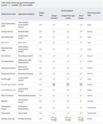

The good news is that I have finally managed to pair iHost with Google Home. The app showed all the devices listed on …/#/matter/support as supported, and the Google platform displays as ‘added’ in iHost. This is where the good news ends. All devices in Google Home are listed as ‘offline’ and cannot be controlled and their property cards cannot be edited. Device names are strings (presumably with some logic in it) of letters and digits.

Google Home and Alexa both need Hub for matter controlling. If you had any one?
What kind of hub do you have on mind?
What is this table supposed to help with?
