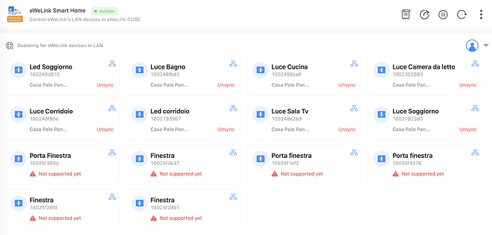

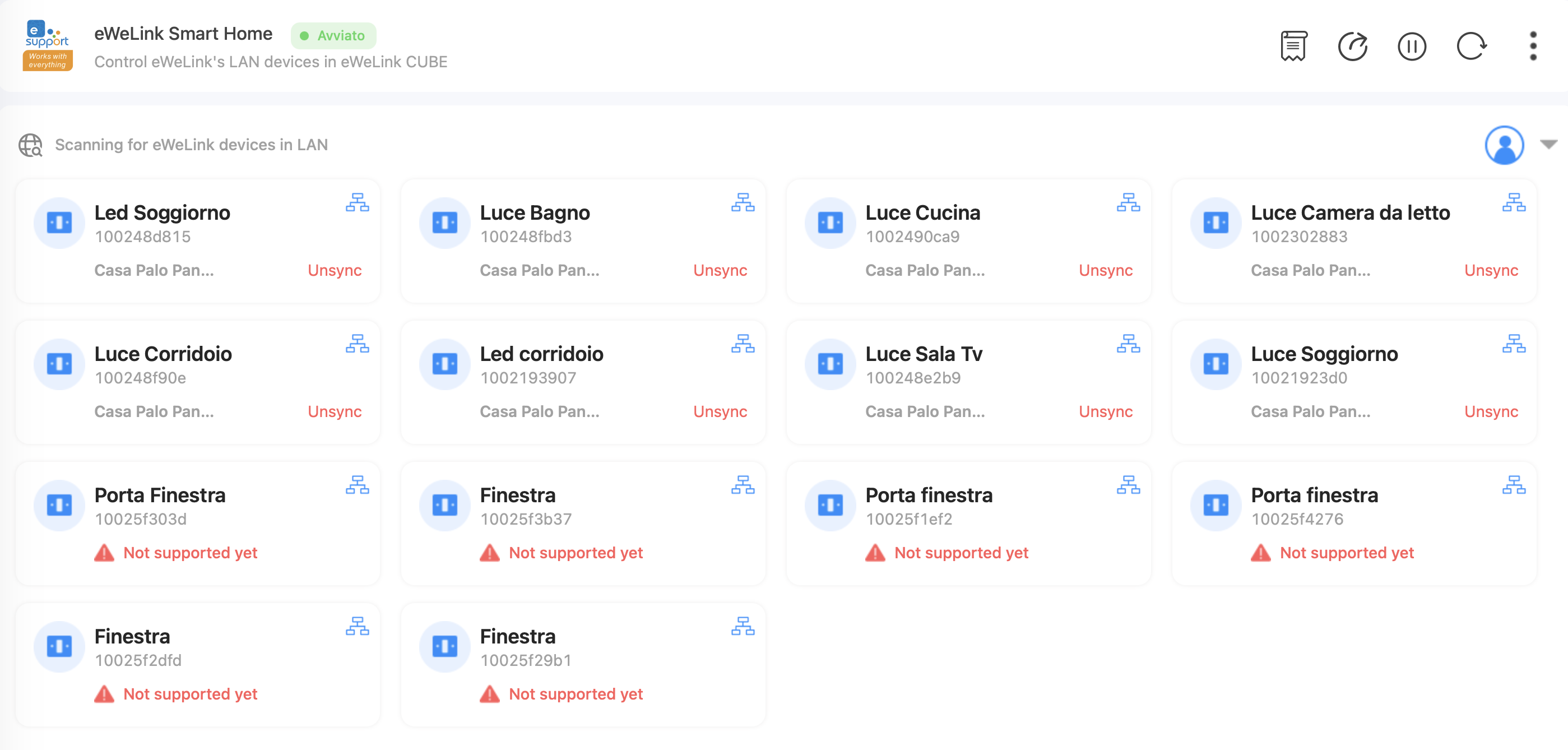

“Add TRV to NSPanel Pro, and then install and configure eWeLink Smart Home Add-on on iHost. This way, you are using eWeLink Smart Home Add-on to export TRV from eWeLink Cloud to iHost. This method should work right now. If you met issue using this method, please let me know.”
The TRVs do not appear in the smart home add-on (they are all currently configured in the eWeLink app via NSPanel Pro 120)…
