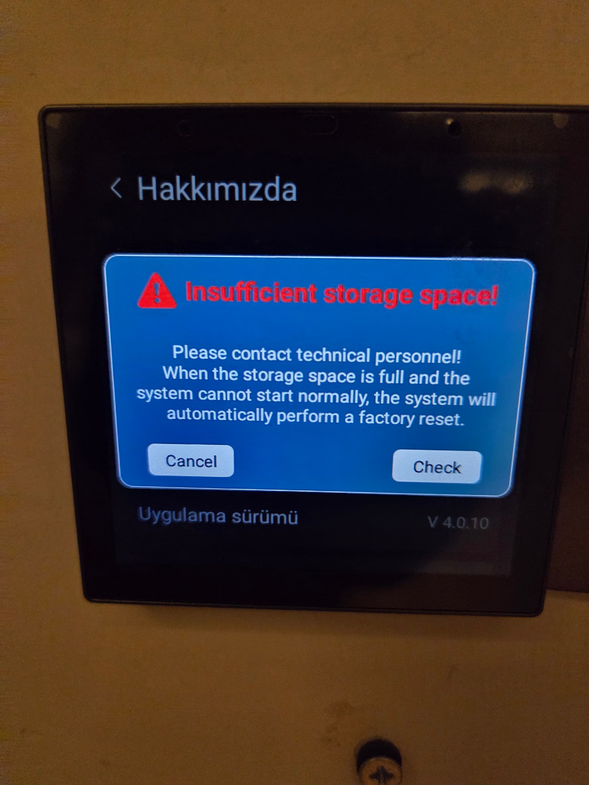

Same for me. There is no added any application extra. What can I delete ?
Update:
I download Fossify File Manager on F-Droid. I found small things for delete. And I delete storage of F-Droid so I save 1GB space for update and I updated my devices. But we have to delete old update apk and zip file for more space we need password for this.
Update 2:
I think deleting F-Droid data wasn’t a good idea. The update is now complete, but F-Droid Installed Apps do not appear. I can’t even search to access File Manager.

Hi, sorry for the issue. There is a bug in previous and current v4.0.x firmware which doesn’t delete used OTA files. So after several update, these unnecessary OTA files have occupied a large amount of storage space.
You can follow the steps below to clear these OTA files. As a side effect, you will need to reconfigure your NSPanel Pro after that.
Note: Reconfigure only involves Language Setting, Country Setting, Custom Wallpaper, Custom Ringtone. Zigbee network, Wi-Fi etc., remain intact.

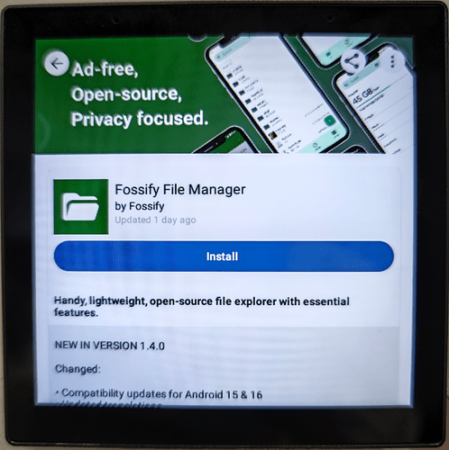

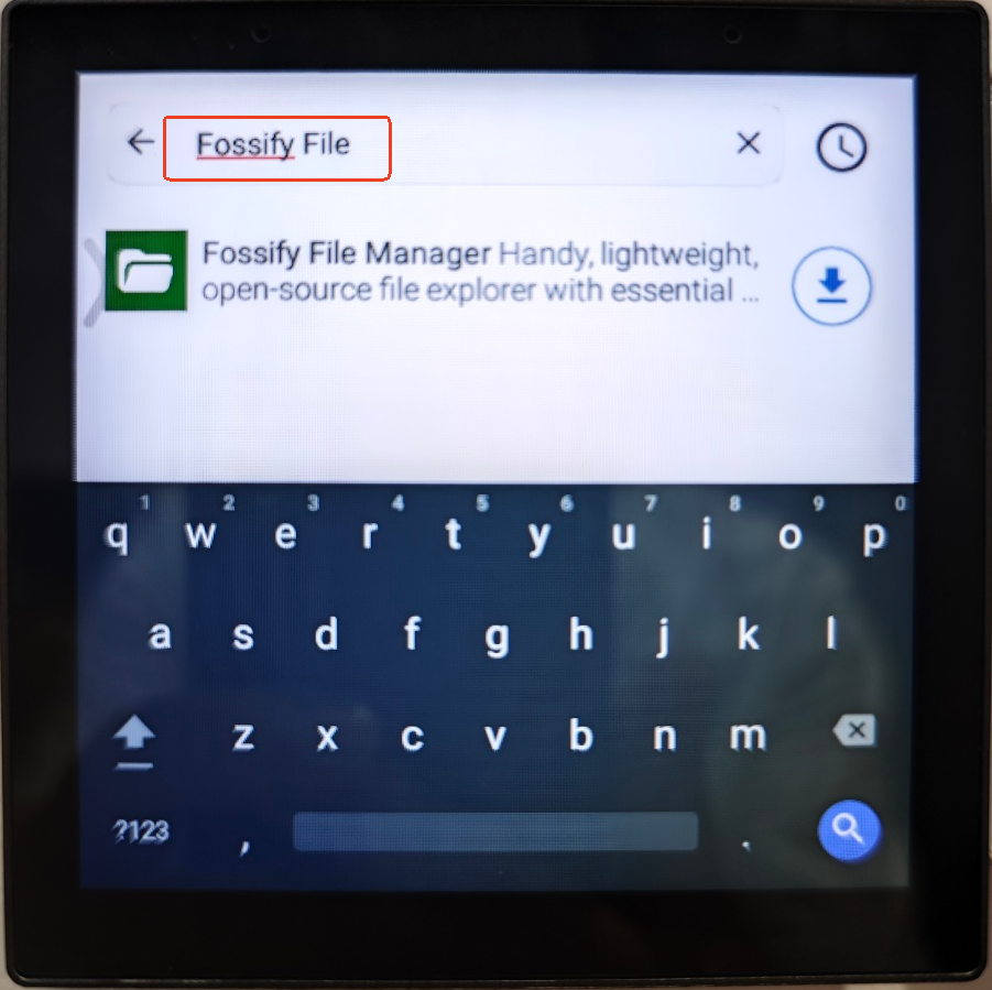

  1. Install Fossify File Manager through F-Droid (Top drop-down menu -> F-Droid -> Latest -> Search "Fossify File")

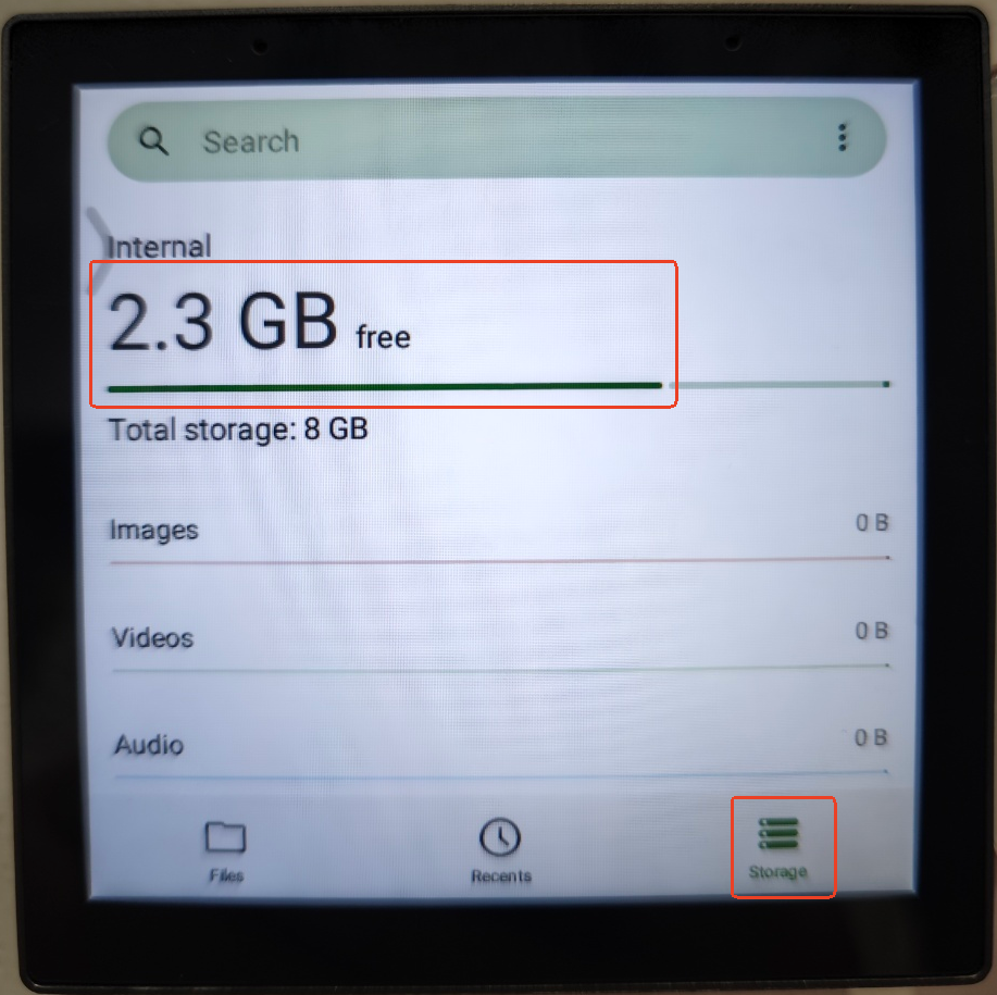

  2. Open Fossify File Manager and press bottom tab Storage. You can see how much storage space is left. It should be 1.8GB at least in normal operations.

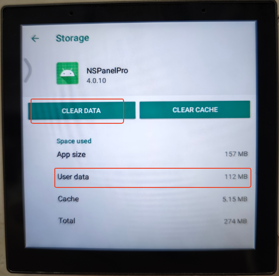

  3. Press the number of the free storage, scroll to Other apps and press it. You can see the list of installed apps and the storage space they occupy. NSPanelPro App should take no more than 500 MB. In your case, NSPanelPro App is possibly occupying more than 1 GB storage space.
  4. Press the name of NSPanelPro App, and then press CLEAR DATA button to recycle storage space. You will notice the AssistiveTouch button on the top left side is gone, because NSPanelPro App is stopped in order to clear its user data.
  5. You need to power off NSPanel Pro device in order to reboot into Home screen again.
Please let me know if above method solves your issue.
