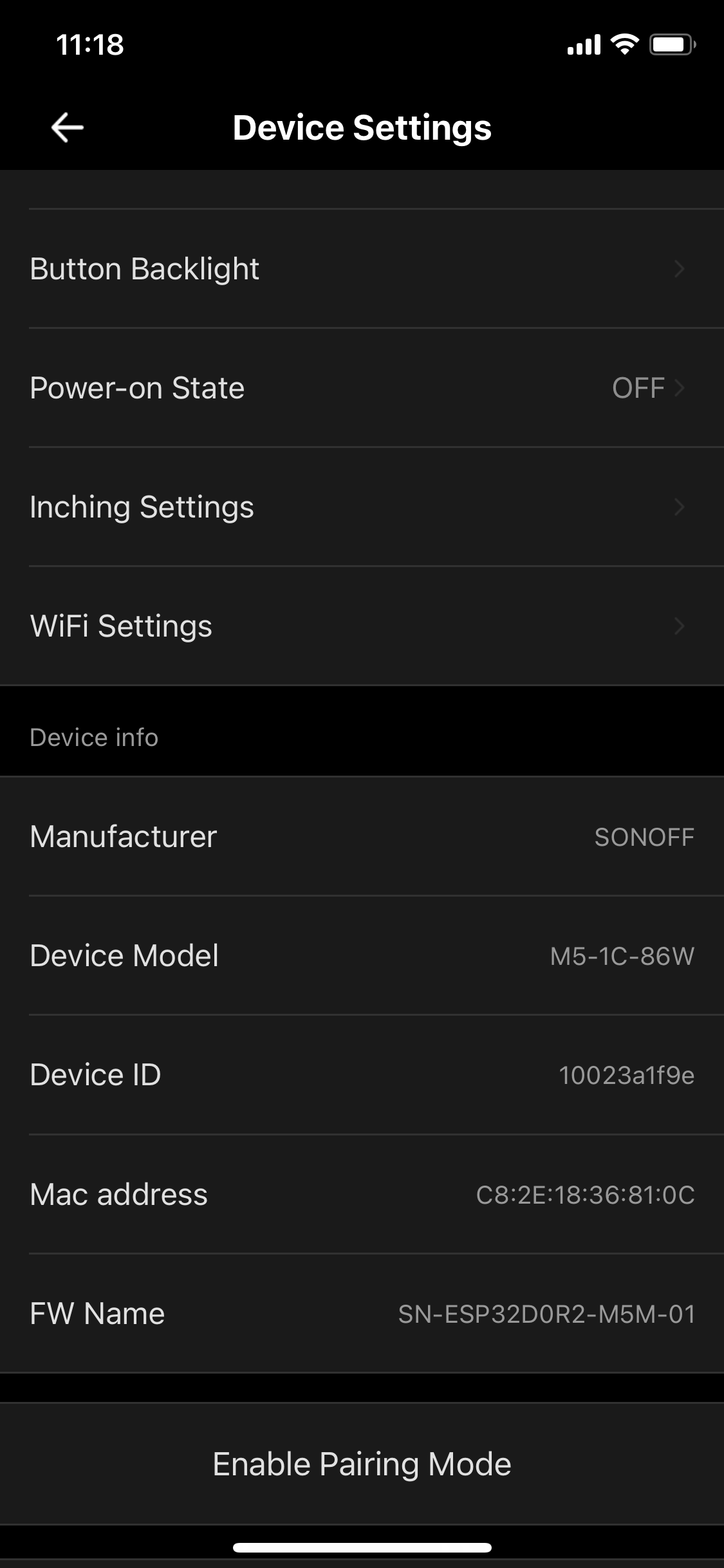

Hi, I’m having troubles to add those switches from the title to iPhone widgets. All other sonoff devices I have could be added without issues. Any suggestions what I did wrong or they are not supported yet?

could you attach the screenshots? This device has been supported for iOS Widget in App V5.11
Hi, here are few screenshots I took, I’m not sure what exactly to upload …
All my devices
Kitchen, living room and other are on the 3 gang switch, the bedroom is on the 1 gang switch. Both are not visible when adding widgets.
