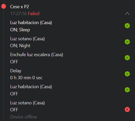

I have posted before. EWELINK loose SONOFF bulbs. They are linked in my Wireless but ewelink does not see them. So, scenes fail. I add wifi configuration. It´s normal configuration, without strange settings. ASUS RT-AX82U with last firmware
Please What is going wrong?

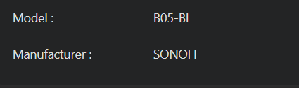

Hi there, does the issue occur with your other bulbs (of the same type)?
at least two bulbs have the problem. I think this is a firmware problem. I have seteted the bulbs and reinstalled. I think a finetune firmware for wifi connection has to be made

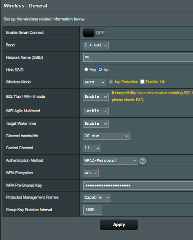

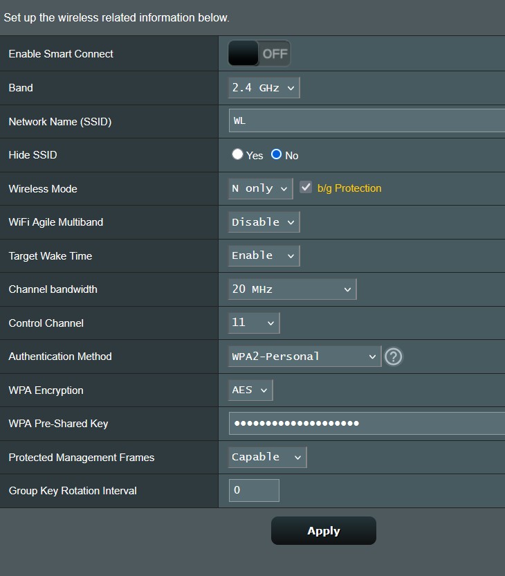

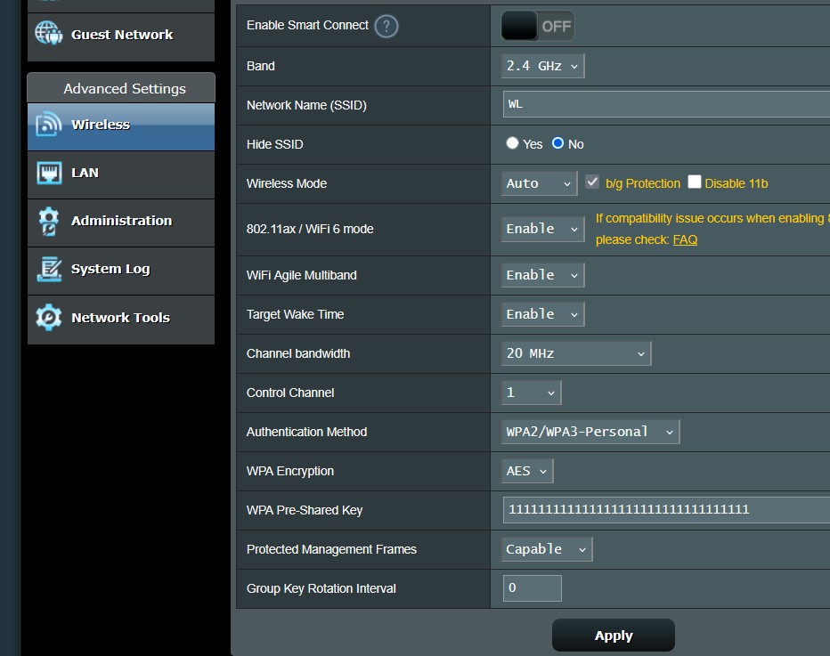

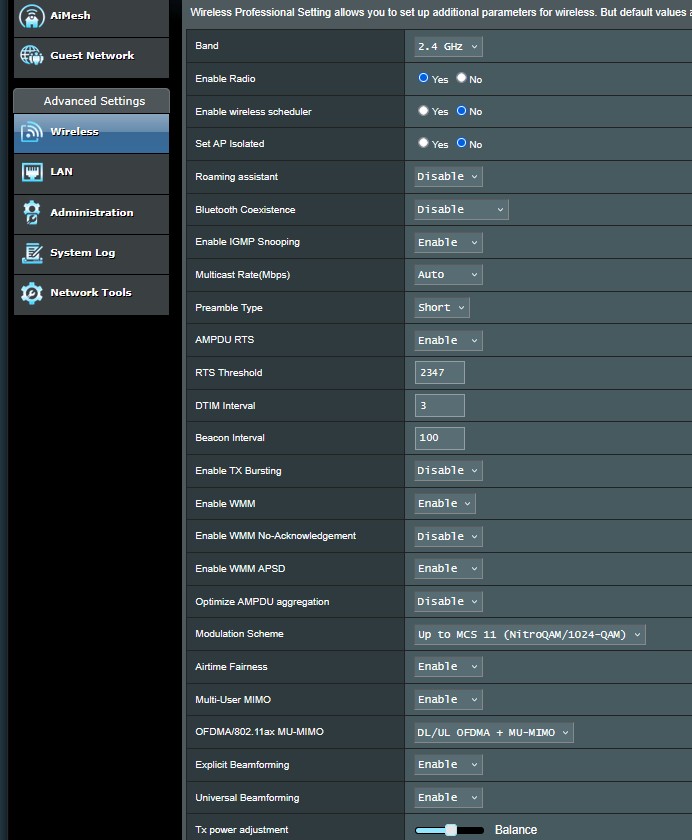

I am going to open a ticket for you to see the logs. I think this is a BL602 problem, that can be fixed with firmware upgrade. I attach WIFI settings. All devices are in the ASUS RT-AX57 in AP mode. I put here myy wifi settings -very common settings- Bulbs log can discover the problem.
For security reasons I have to be sure connectivity is OK, so, I have set WIFI to a very conservative settings: I expect no device will loss connection with theses settings
