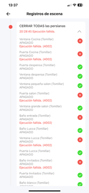

Hello,
I’m facing an issue everytime that automatic routine is executed.
Error 4002
I have many curtains with sonoff dual R3 connected by wifi. When I open or close all with automatic escene,
I see many times that not all are open/close. When I check the log, I see this:
What can I do to solve it? I need to be sure that all curtains are open or closed when routine is executed
I have ihost hub with zigbee sonoff ZBMINIR2 devices for the lights and wifi sonoff dual r3 for curtains.
All are sincronized in ihost hub

Hello,
Error 4002

Screenshot is from ewelink app
Error code 4002 indicates your devices are offline so they can’t work according to the scene.

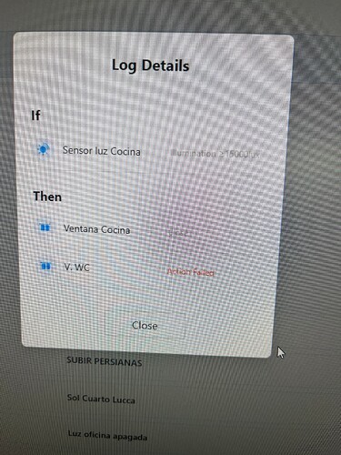

I’m checkin log details in inhost in the laptop.
I see that Scenes fail many times, wheter manual or automatic.
If I activate manual scene of closing all curtains, many times I find one or several that didn’t work
Also automatic scenes. For example I have light sensor to close the curtain. Today the ligt sensor gave the order of closing. The first time failed…second time succeed.
See pictures below. The mouse is pointing the first time (failed). Next time, 5 seconds later succed.
