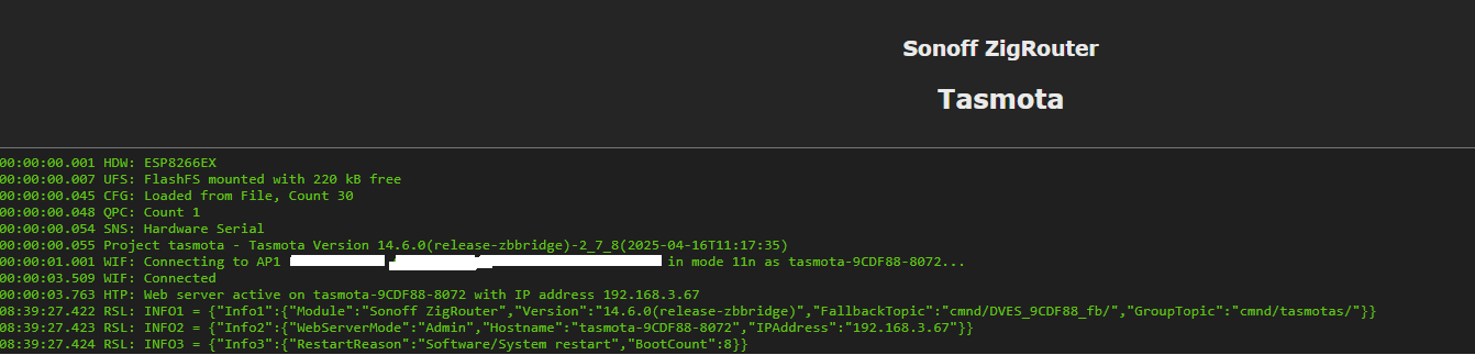

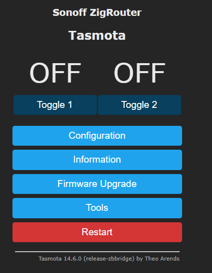

I successfully flashed zbbridge, but it does not connect to ihost. I began to doubt whether it can connect to ihost and be used as a router?

The device was successfully added to the ihost, but it was added as a wifi device. I’m trying to add it as zigbee, but ihost can’t find a new zigbee device.
Have you seen this tutorial? Because you need to enable the ability for the reset button to be used for pairing procedure.
