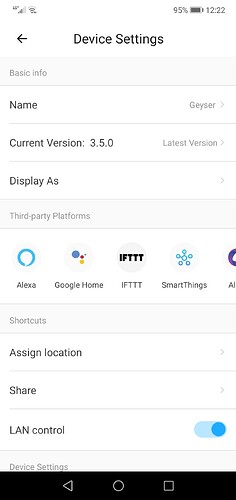

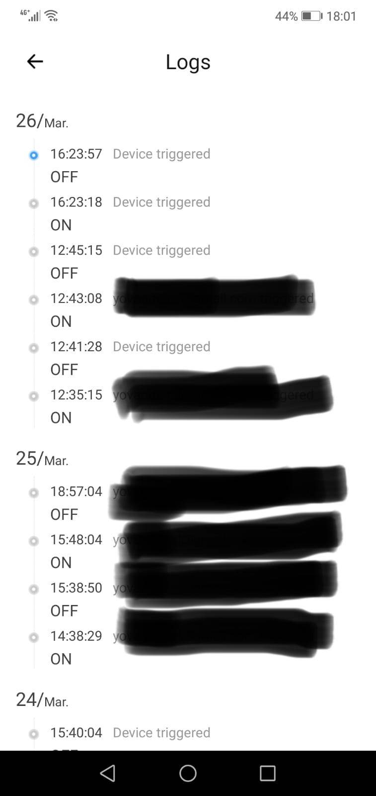

My sonoff geyser breaker switch, is just going crazy since the 25 March ![]()

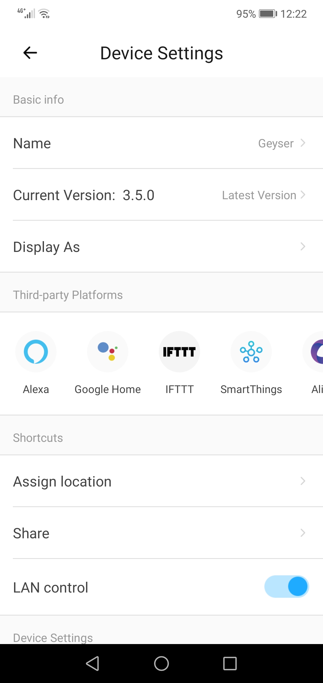

May i know the device ID that in your screenshots?

I noticed that it looks to restart because it triggers ‘Device-Power-On state’. I have configured to be off in settings.
When it Powers off, it takes like 10 to 15 seconds to be able to turn on again via ewelink app.
