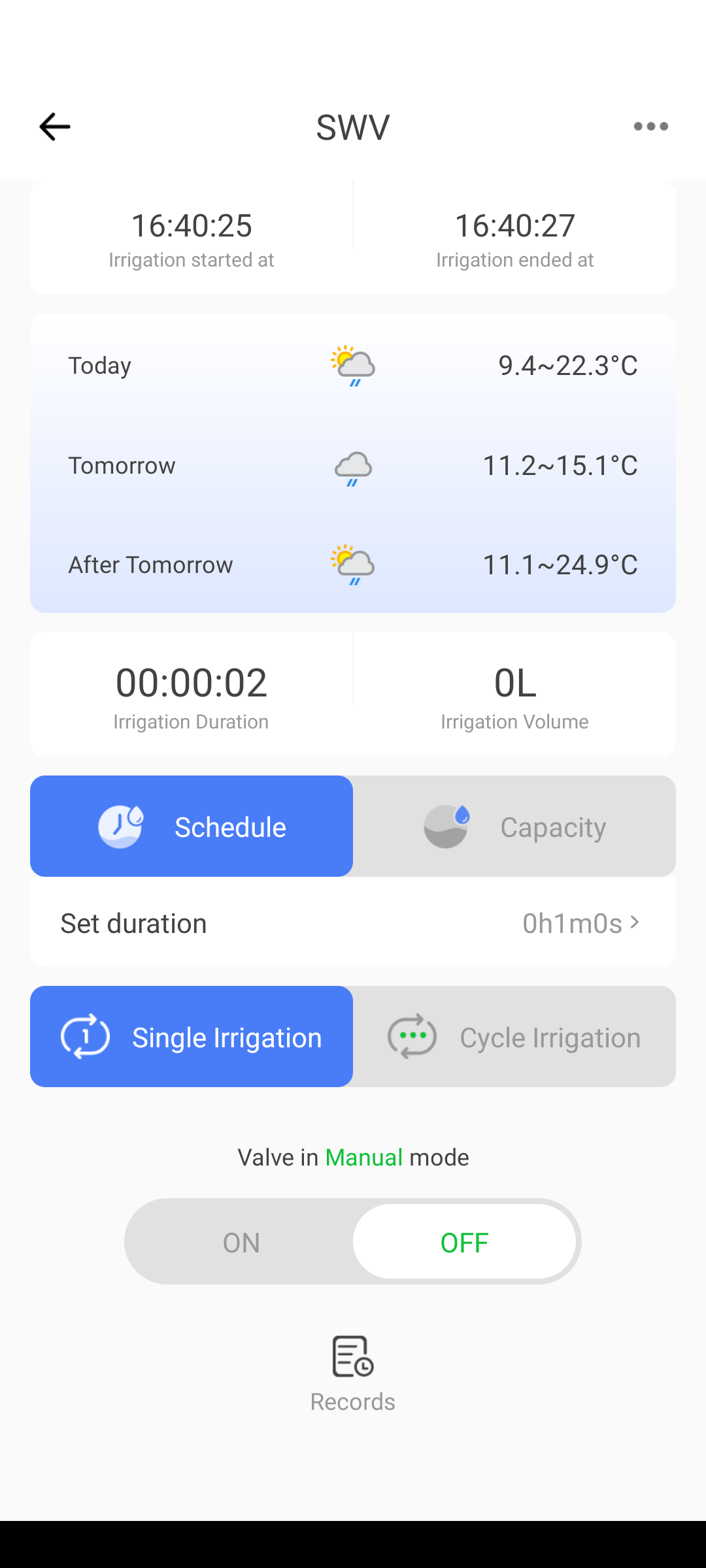

Nella configurazione della Smart Water Valve c’è la voce “Cycle Irrigation”.
Ha 2 parametri “Irrigation Times” e “Interval” .
A cosa servono e come funzionano?
Grazie
Hey there! :blush: Simple way to think about it: Irrigation Times is how many times it’ll water (like 3 times), and Interval is how long it waits between each watering (like every 2 hours). Hope that helps!
I can’t find the timer settings anywhere if I want to start watering at a certain time is it necessary to create a scene? or is there a timer like with other sonoff devices. further displayed weather has any functions or is it just informational. when I connected swv to a non-original gateway the timer is there but again it is wrong smart water measurement functions
Hi there! Let me help clarify:
  1. Yeah, there’s no timer on the SWV yet. Creating a scene to start watering at a certain time is the workaround, just like you said.
  2. As for the weather—it’s just for your reference, so you can easily check it and adjust your watering plan if needed.
  3. About the issue with the non-original gateway—could you share a screenshot? That’ll help us figure out what’s going on.
    Hope that helps!

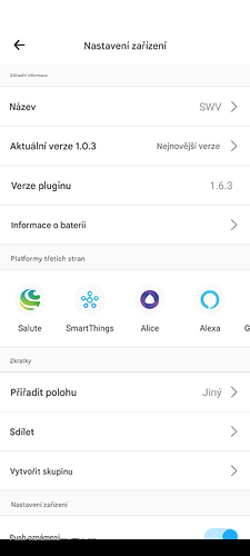

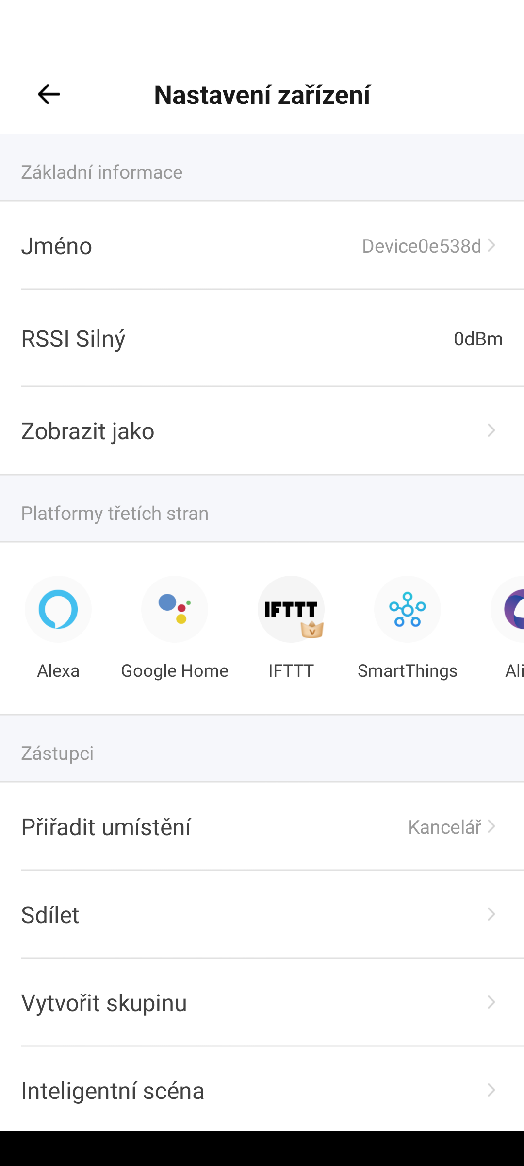

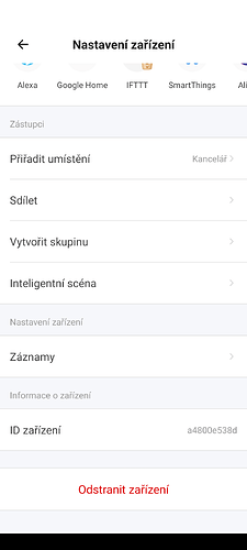

Hi, I am sending a display in sonoff bridge pro
The screen is in English only.
It also seems that if the device is offline on the bridge for it is not seen in the application, it only reports an error when I want to perform an action
This is what the translation into my language Czech should look like

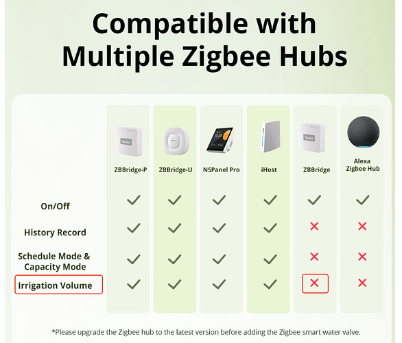

This is what the non-original gateway device “ZBG-AB1-GL” looks like, the gateway updated to the latest available version 1.1.6
Hi, thanks for bringing these up!
1.Czech translation — we’ve forwarded it to our translation team and they’re working on it.
2.About the offline device not showing in the app — we’ve noted this, and it’s already on our list for future optimization. It might take some time, but we’ll work on improving this experience.
3.As for the non-original gateway “ZBG-AB1-GL”, apologies for the limitation — it doesn’t support the irrigation volume feature. You can check the product details here: [SONOFF Zigbee Smart Water Valve | ITEAD STUDIO OFFICIAL]
Here’s a quick screenshot for reference:

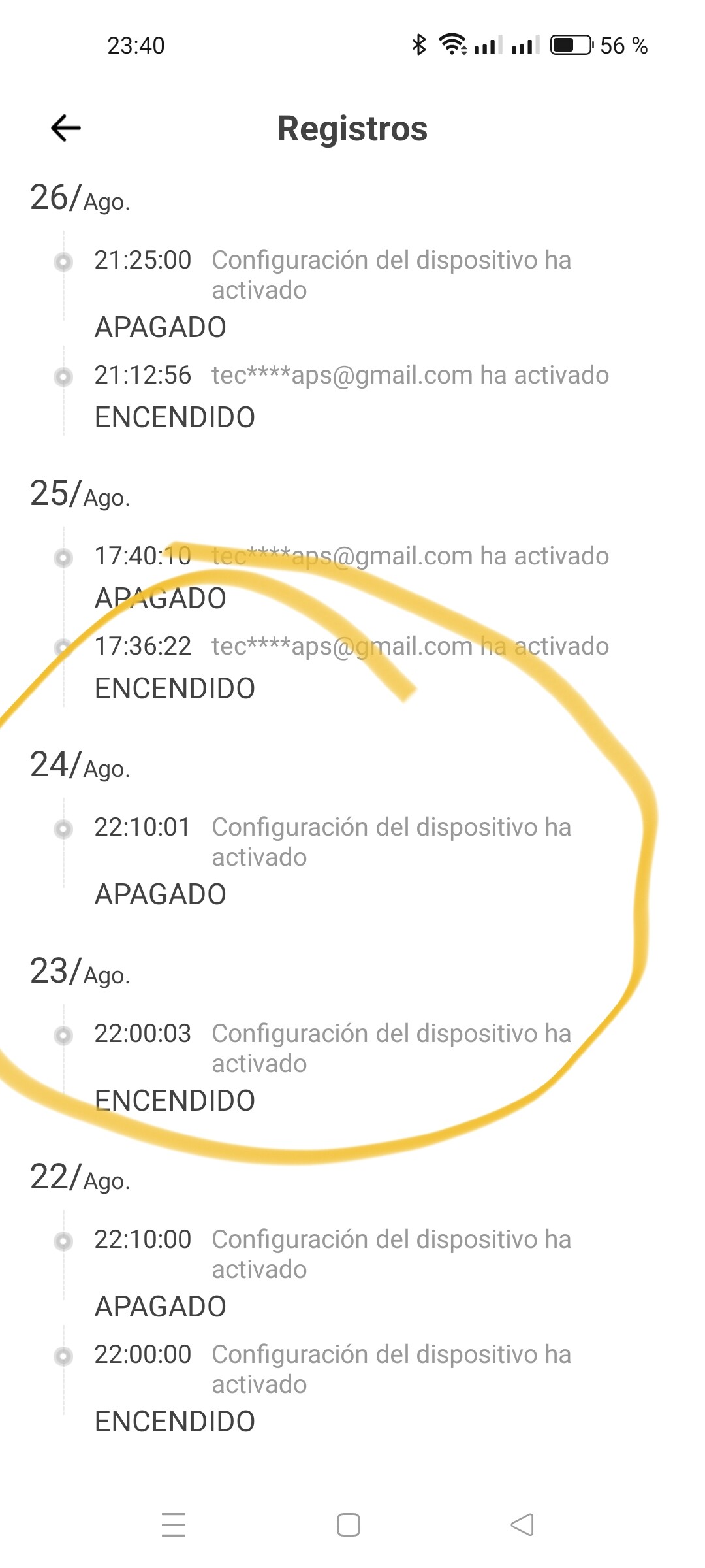

This device fails a lot. I have a scene scheduled for it to water ten minutes a day, but on occasion it turns on the water and doesn't turn it off until the cut-off time 24 hours later.
This has caused me to waste 7000 liters every time it fails and flood my garden. It is not reliable at all, I do not recommend it
