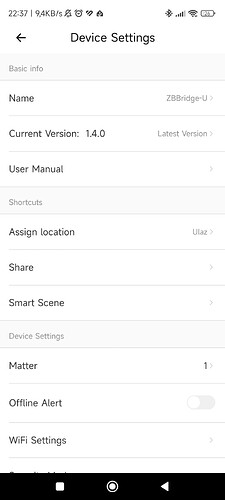

I connected my TVRZB to the Sonoff ZBBridge Ultra without any problems.
The firmware on my TVRZB is 1.1.5, while on the Sonoff ZBBridge Ultra it is 1.4.0.
