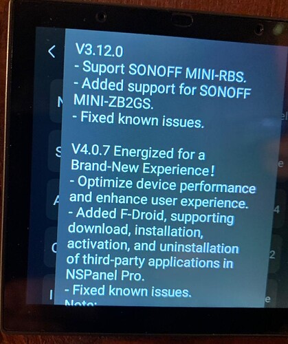

Current version 1.3.4. Panel indicates that a new version is available. When I click on the “Update Available” button, a list of improvements is displayed, but there is no way to scroll down to start the update. How to update?

Unfortunately, the update still doesn’t work.
I restarted the panel, under update, the same list of changes, I can’t scroll down to start updating.
I also did a reset. The only difference is that before it updated to the intermediate 1.3.4 version, now it offers the new one from the original 1.3.2 version. And the latest version can’t be installed.
Couldn’t the start update button be above the list of changes?

Could you take a photo of your NSPanel Pro on Settings -> About -> Software Update page, so we could better understand your issue?
Hi, the upgrade notification has been updated. You should now be able to normally update to version 4.0.x. Please check in the settings page to try it.
