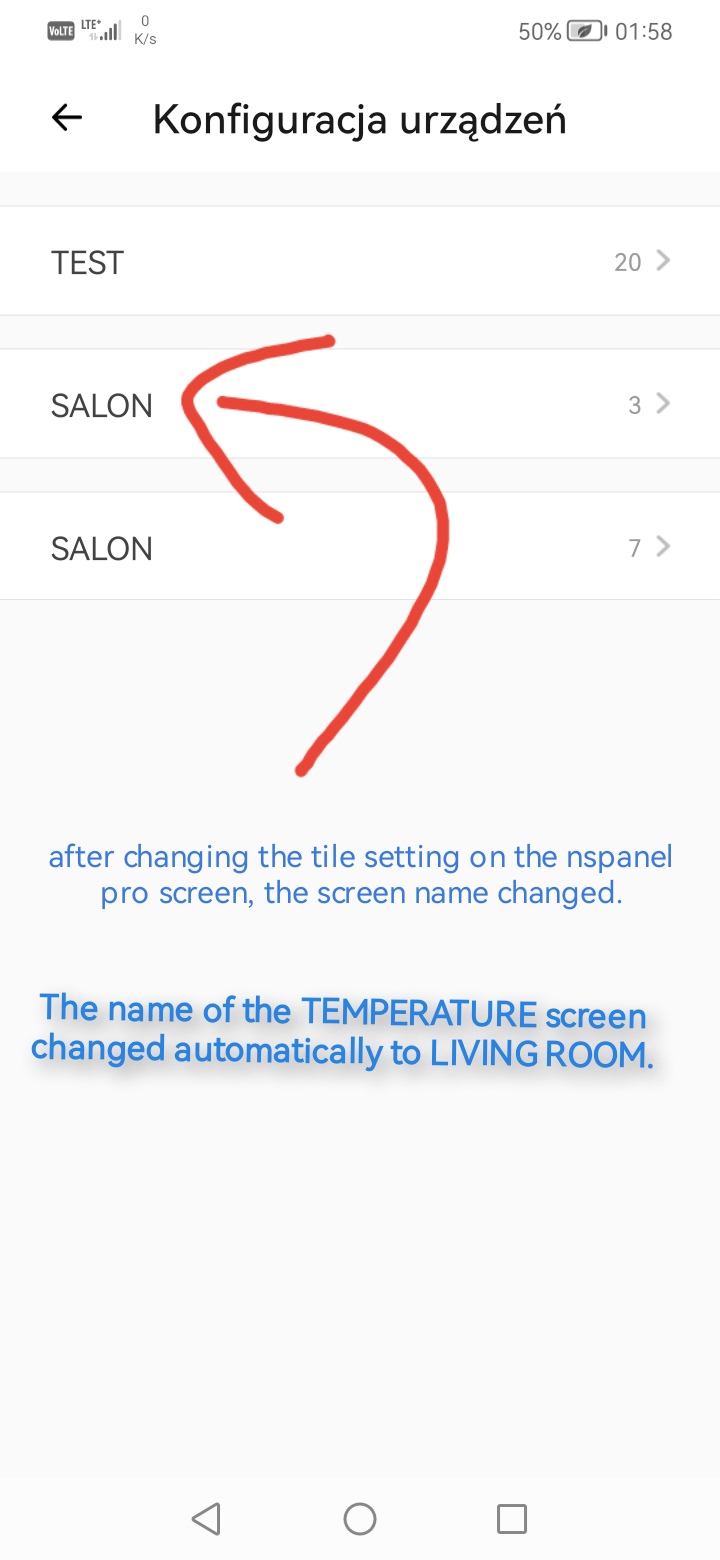

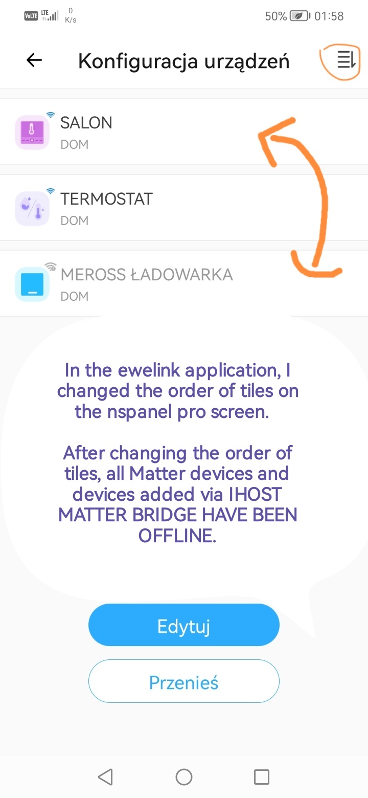

In the ewelink application, I changed the order of tiles on the nspanel pro screen.
After changing the order of tiles on the screen the name of the TEMPERATURE screen was automatically changed to LIVING ROOM.
Additionally, all Matter devices and devices added via IHOST MATTER BRIDGE HAVE BEEN OFFLINE.
I restarted nspanel pro and ihost but the devices are still offline.

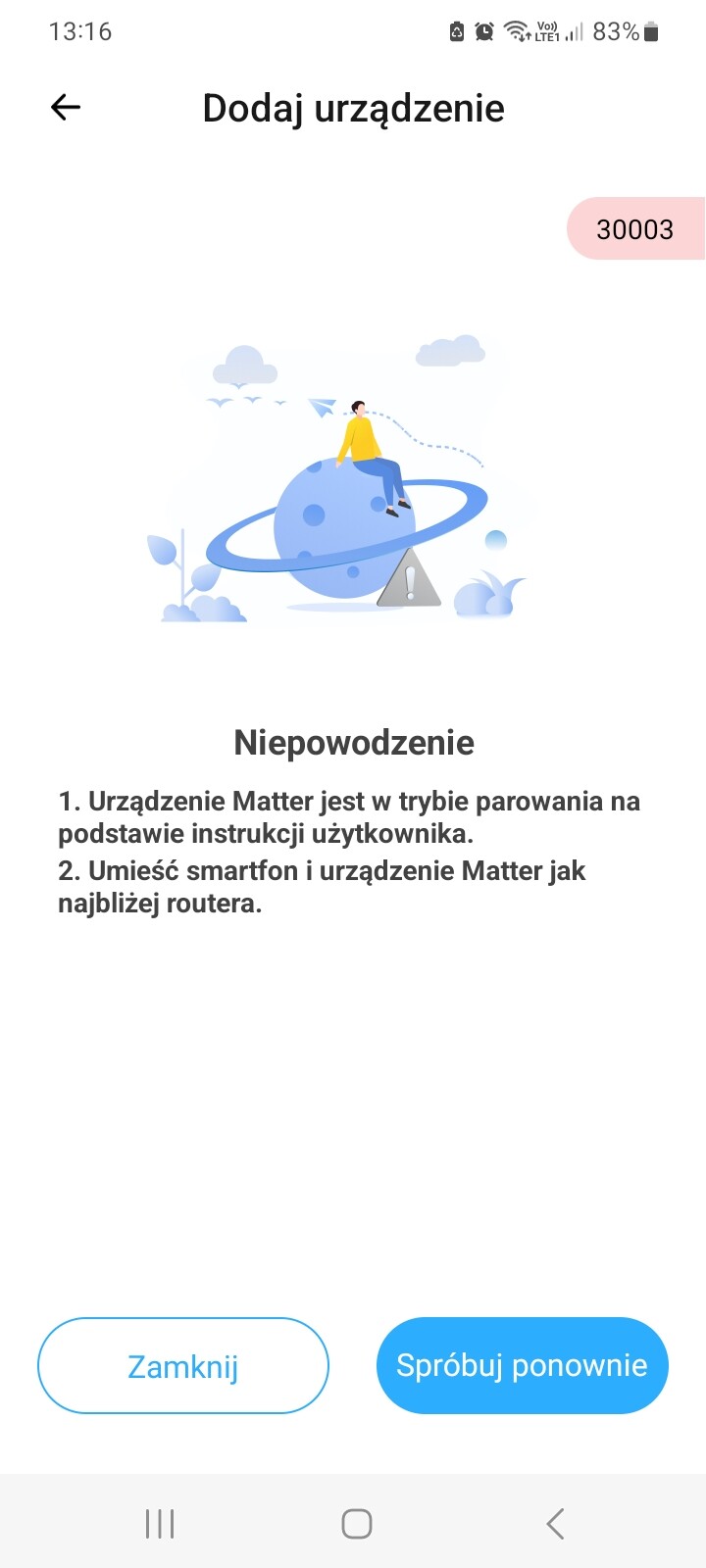

I noticed that if the Ihost matter bridge is offline in the eWeLink application and on the nspanel pro screen. It is in the ihost (matter bridge) menu that pairing with ewelink is removed.
If I re-pair, it displays error 30003.
Re-pairing can only be performed when we remove the inactive matter bridge from the eWeLink application.

I wasn’t so lucky, because Zigbee devices were not added. I severed the connection and tried again. This time the connection failed despite several attempts. Instead, the NSPanel Pro screen displayed a message that the LAN devices were on the same network.

To perform re-pairing, you must first remove the matter bridge in the eWeLink application if it is displayed. I also restarted nspanel pro because it was not detected in the network.

It appears that the problem with the iHost Matter bridge is in the eWeLink cloud. After an overnight pause, re-pairing with NSPanel Pro was successful. As before, only devices connected via the eWeLink Smart Home add-on are visible in the app. No Zigbee devices despite the fact that, according to the summary in iHost, they are supported. Of course, this makes the whole action taken pointless. Makes me wonder if the lack of Zigbee from iHost is influenced by the fact that I added Matter devices to SNPanel Pro and that it was already acting as a Matter hub. Because why in my case are Zigbee devices from iHost not added to the cloud?
