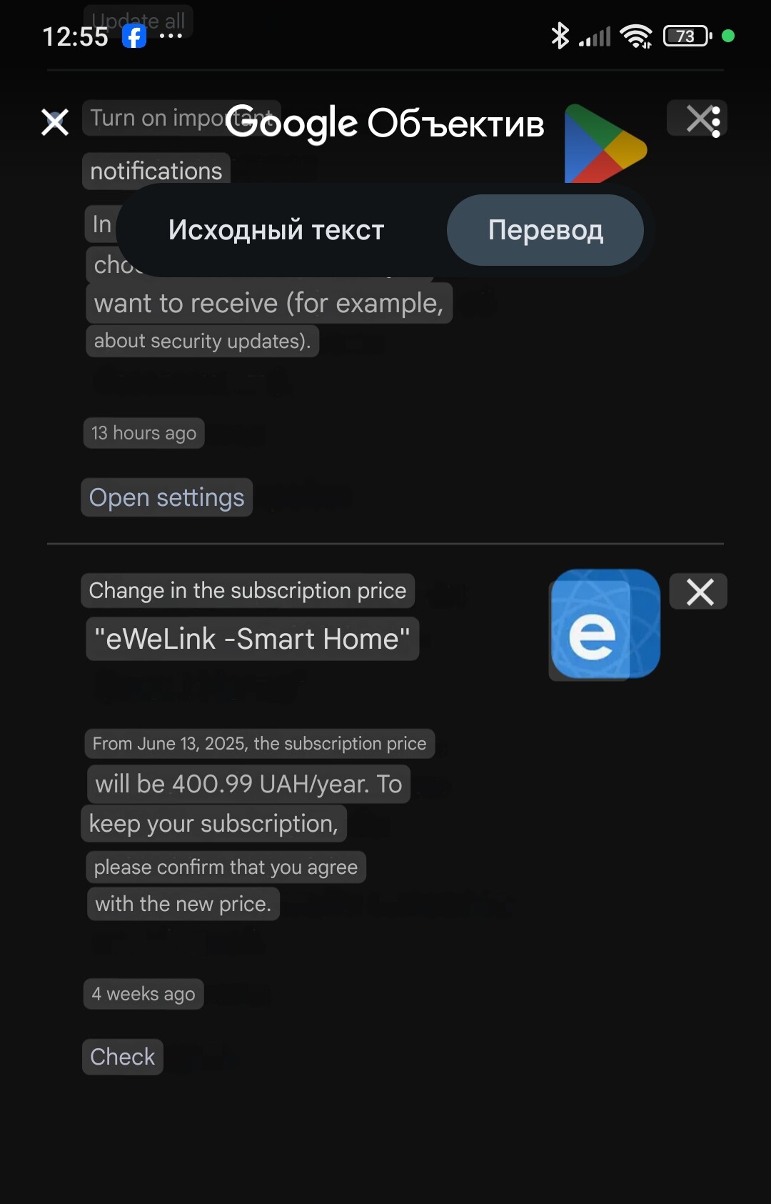

Putin wants to control many things, including my life. I connected devices to another account and everything works fine, all scenarios are created. I conclude that the problem is in my main account, where all my devices are located. I can’t understand how this can be? There is one thing, I received a message in Google Play about increasing the cost of a subscription to Ewelink by almost 2 times. It seemed suspicious to me that it specifically said “Ewelink subscription” and with the Ewelink logo, and not “Ewelink cast” and the Cast logo. But I still confirmed my consent. Well, this is Google Play and it is doubtful that there would be some kind of catch.
As far as I remember, the subscription is not sold in-app, so you can’t get offers from Google Play. Unless I’m mistaken, an annual subscription costs 9.99USD and hasn’t gotten more expensive in a long time.

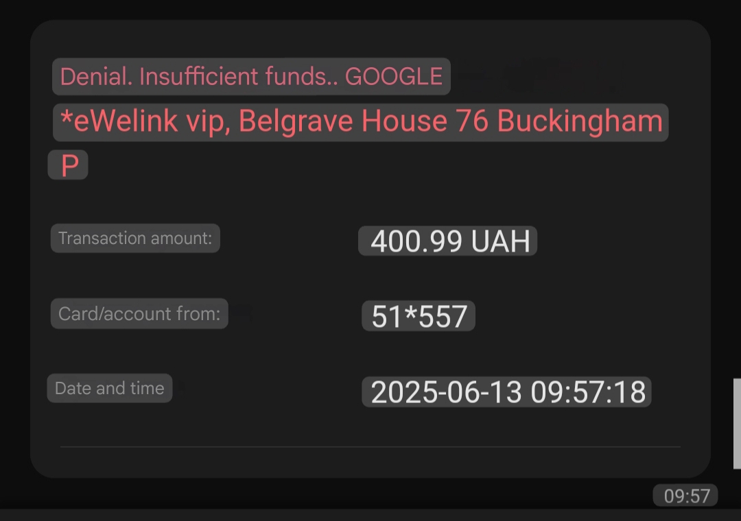

I don’t know what they offered me to buy. Everything is clearly indicated on the screenshot. And today I went into the bank’s program and saw a message that payment was denied. Thank God I haven’t topped up this card for a long time.
Never click on the links that are in the message especially when it concerns money !!!
For Ewelink, pay directly to them through PayPal. https://vip.ewelink.cc/
The thing is that there was no offer to pay for the subscription, there you had to click “agree or not” with the increase in the price of the subscription. Well, I’m already a VIP client of Evelink and if the price went up, then what can you do, I clicked “yes” and they tried to withdraw money from the card. Well, everything was sort of resolved with that. They didn’t withdraw it and that’s good. I assumed that this was the case that caused the problems with Evelink, I thought that maybe I caught a virus. Everything works very poorly, it’s especially unclear why I can’t create scenarios in one account (the main one), but in another without problems. When creating scenes, the program freezes and I have to reboot it. The phone has enough RAM.

The subscription is 9.9 USD/year, the price change is caused by the fluctuation of exchange rates.
Advanced Plan was launched on Google Play Store in September 2021.
Really? But probably not in the typical way through Google Play, right? That’s what I meant. I’ve always paid without going through Google.
Yes, the subscription needs to be processed through Google Play.
“Well then, I graciously skipped that ‘pleasure’ and paid directly on the eWeLink Advanced Plan site. No commission for Google. Sorry, Big G, not with me! :smiling_face_with_sunglasses:

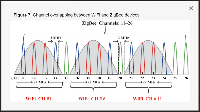

When zigbee plays up its usually interference with wifi. I dont have yr kit but for me my wifi and the neighbours wifi was clashing with my zigbee channel.
Set wifi to 1 or 6 and 2.4 ghz to a 20mhz band and zigbee on 25 which is wifi channel 11 at the opposite end and that may help as nothing overlaps.
Just check what your neighbours use first of course and adjust but stick to those 3 channels
