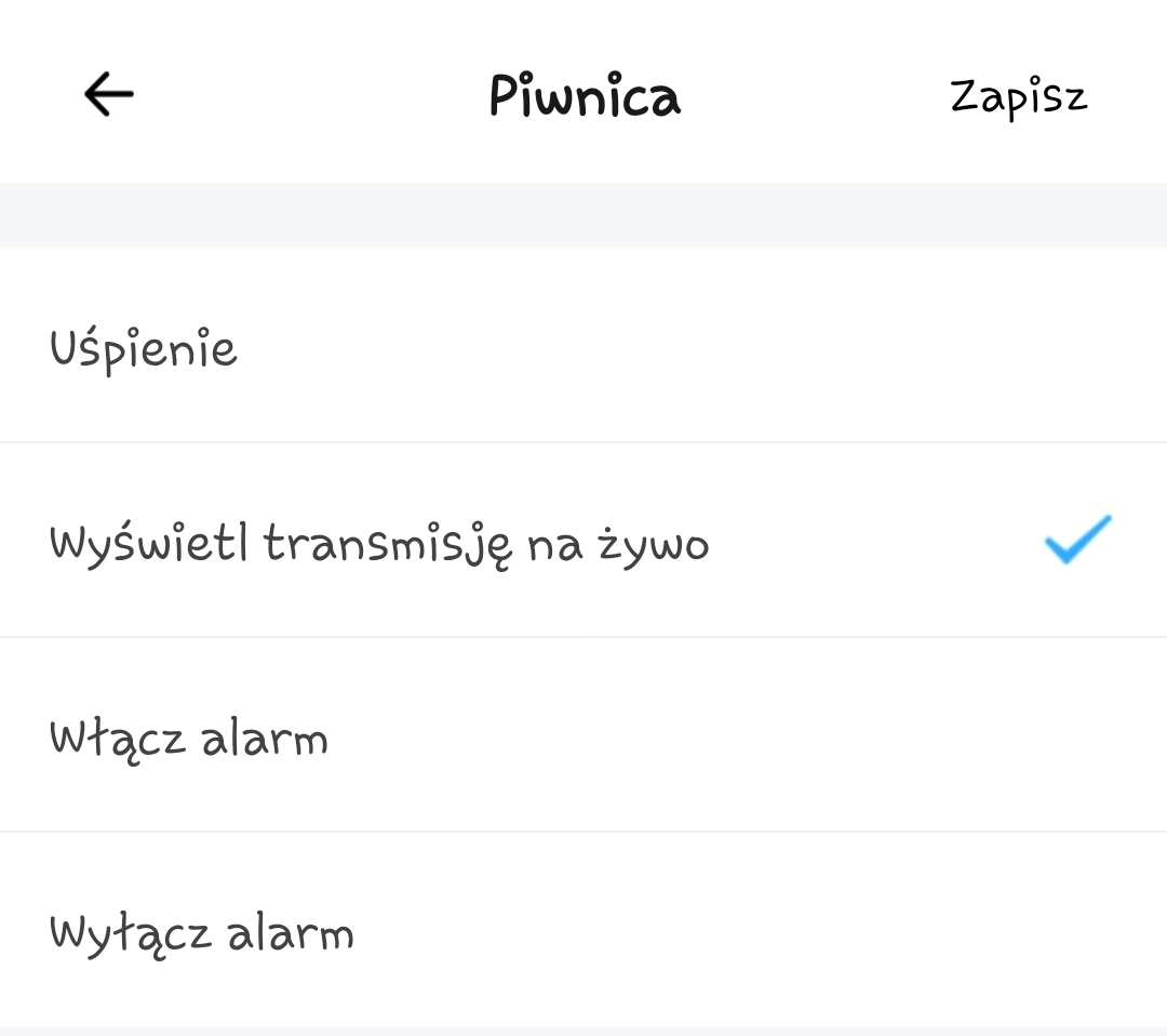

Helo
I have bought nfc tags to automate my camera…
One of them after scaning works great… it activates sleeping mode, but the second one doesn’t…
eWelink doesn’t allow me to pick deactivate sleeping mode after scaning
Do You have any ideas how to bypass and make this work?
Edit: problem solved
I had to choose live view (option below activate) instead of looking for deactivate :smiley:
