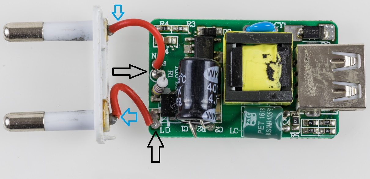

Buy a very small USB charger, one USB port. Remove the plastic casing, unsolder the cables and solder L and N. Wrap it with electrical tape, hide it in the hole and run a normal USB cable to the sensor.

it is dangerous. That is why usb chargers come with a plug and not just the L/N cables for you to figure out how to connect them. :slight_smile:
basically, if you don’t have a socket in the place where you want to install it, call an electrician to install one and plug your charger there, hide the usb cable under the wall paper or whatever helps.
