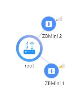

What is shown here is not signal power and signal strength … Instead of RSSI, the zigbee map showing LQI. If you look at the details page of this ZBMini 2 device, you may see that the RSSI probably shows good.
LQI measures the overall communication effect - even if the transmit power is adjusted to 100db, it will not necessarily affect the display here.

I think it is how they display the map on the iHost when compared to ZHA and Zigbee2MQTT. I suspect there are side to side connections but they are not displayed. The routing of devices is weird on ZHA & Zigbee2MQTT too but it’s harder to see on ZHA/Zigbee2MQTT. I personally prefer their map approach. Also in Zigbee2MQTT (and maybe ZHA but I never saw it) you can permit pairing only to a chosen router. That way you can force a more sensible route, but once part of the network they will still go insensible over time.
This is the way it is displayed FYI:
