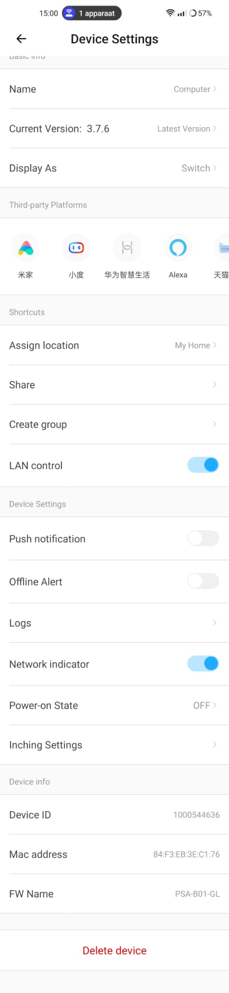

Not all devices support changing the wifi network in the device settings. For example, my MINI R2 and R3 devices do not have it, but the POWR316 do. For the devices not supporting it, I expect you need to pair them again if you want to move them to a different WiFi network.
True that not all devices have changing WiFi settings. May I know your device ID? You can kindly send it to me via PM.
By removing the device from ewelink and then performing a hardware reset of the device and re-pairing it with ewelink.
As you can see, this device does not have an option in the software to change these settings, so there is no other way to do it.
