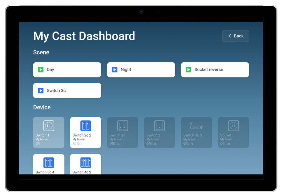

When you’ve configured the Cast dashboards and want to use the tablet as a control panel for a long time, you may find that the tablet cannot hide its status/notification bar (as shown below), and even the address bar of some browsers can take up a little screen height, just a little bit away from perfection.

After installation, open it and fill in cast.ewelink.cc in the Start URL, tap the START USING FULLY to try it.
Now you dashboard should be displayed in full screen like this:
