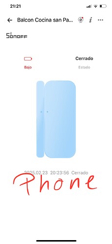

I have twelve DW2 WiFi devices in 3 different houses and all of them have a low battery warning at 2%. I change the batteries and it remains the same on all devices.

I think I know what the problem is. I think the problem is the EWeLink update. I have tried to log in to eWeLink on my iPad. On the iPad the battery level is full. I have checked the eWeLink version and it is older than my phone. On the iPad version V5.11.0 and on the phone V5.13.0.
