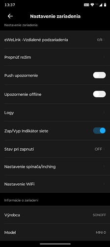

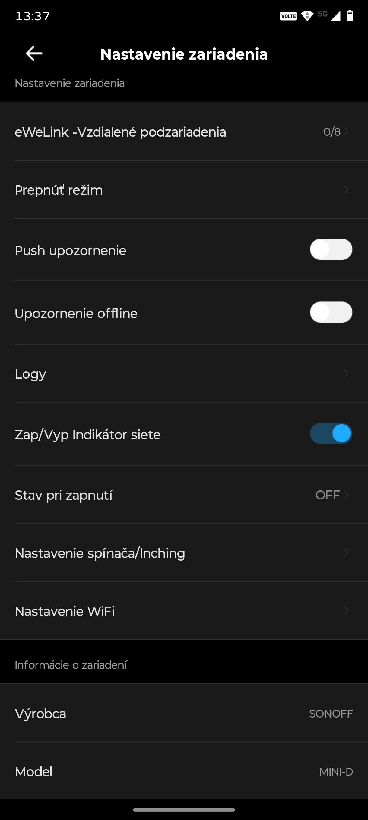

No, it is not possible in my opinion or it will behave unstable. I have tested the Sonoff MINI-D device for dry contact. I installed it in the gate, to control the heating and it works reliably everywhere. The advantage is that it can be powered by 230V but also from 12 to 24V (tested).
I have it connected to iHost, I don’t know exactly whether I paired it or used ewelink smart home.
Brana 587 is Sonoff MINI-D device. It works in local mode without the need for a Cloud.
