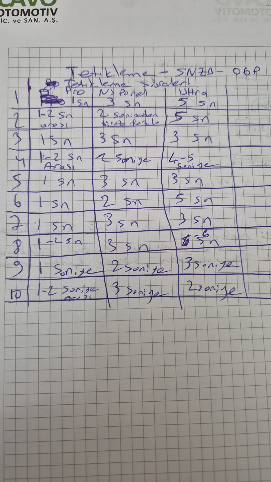

Hi, I don’t use B.ultra for this very reason. Response time is at least 3 seconds. It usually takes 5 seconds. I tested with B.Pro, NS Panel Pro, and B.ultra, and the Pro is clearly ahead. Developers, please improve response times.
