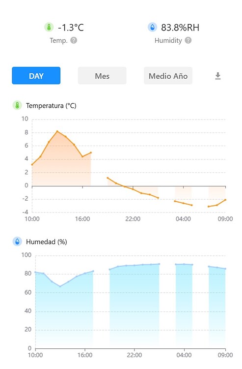

Hello to the entire eWeLink community. I’ve been using Sonoff devices for several years now, and I’m genuinely pleased with the overall results. Some time ago, I started using Zigbee, testing out new features that weren’t available over WiFi. I have a Bridge Pro, but unfortunately, it frequently disconnects. This is evident in the temperature charts, where data is lost on a daily basis.

I had a very similar experience. Constant interruptions, sometimes lasting even a few hours.

And this doesn’t depend on the sensor, as I get the same results on different ones.
