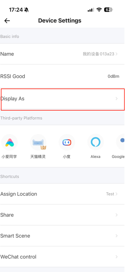

Hello, is it possible for you to take a screenshot to show the device settings interface? like this, you can set it Display as:

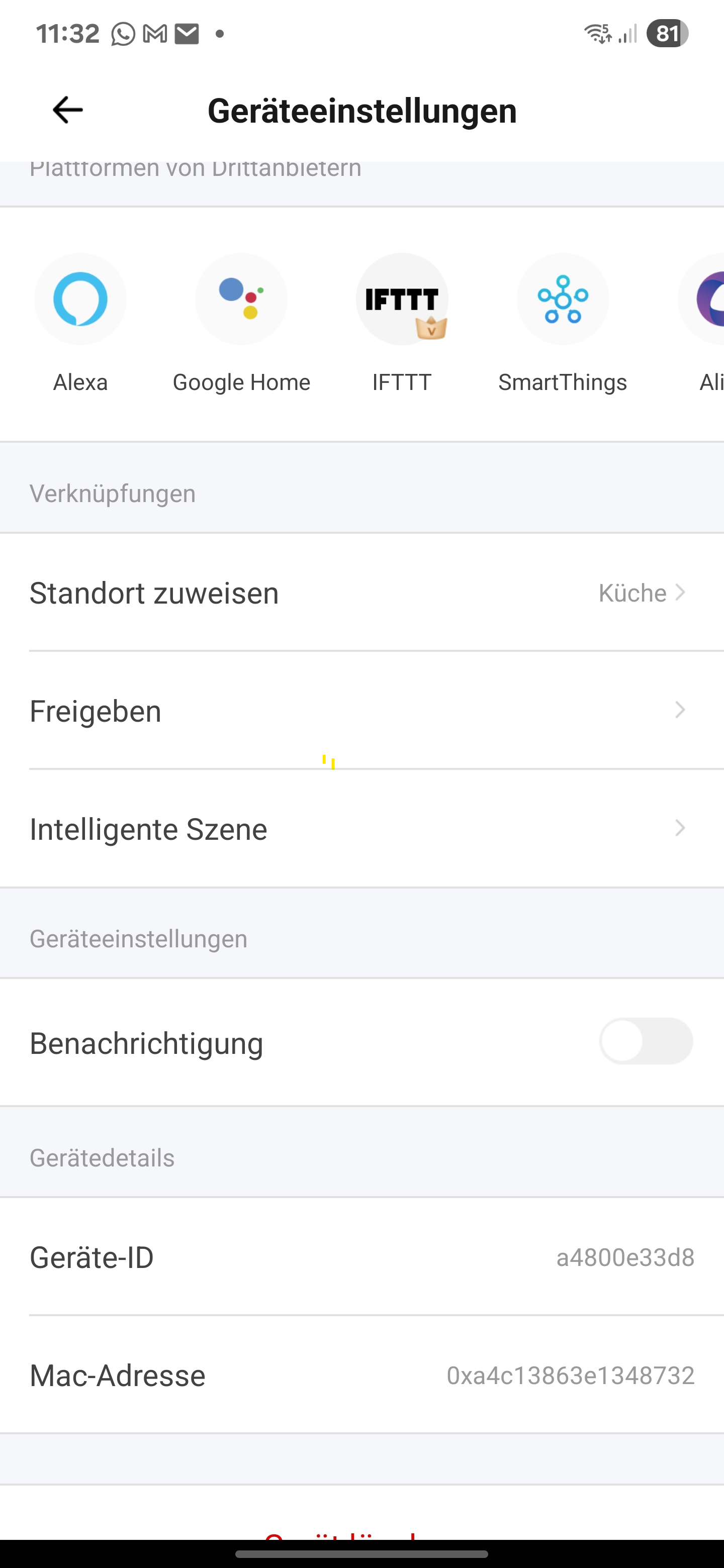

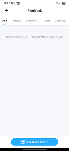

My Feedback page locks like this:
I can’t enter any text there and where do I find the LOG-file?

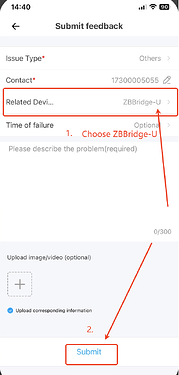

click here:
