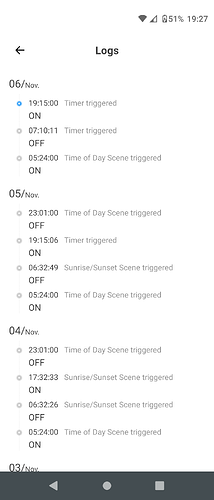

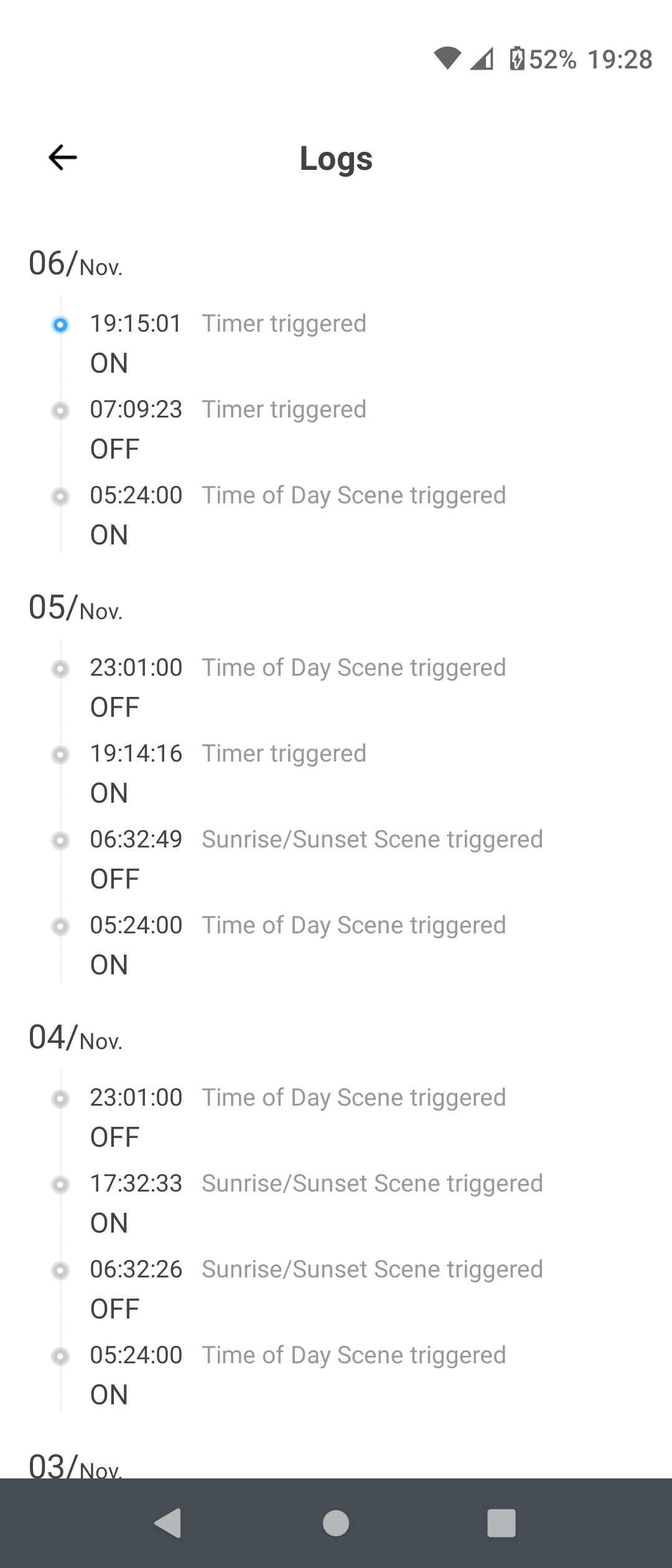

Since the end of the day on Nov 5th (UTC+7), I found that the devices that set to be triggered by Sunset/Sunrise in two difference locations are no longer triggered. The devices are Sonoff RFR2, RFR3, and B02-B bulb. I haven’t touched any settings. Also, I’m not in a country that use DST. I already sent the feedback in the eWelink app, but just wondering that has anyone experienced this problem?

Well, I mean, usually the servers send out the trigger, but the device itself doesn’t respond (from network issue or whatever). The logs will show that it failed to trigger. That would be normal. I’ve seen that time to time. But this is totally different. It acts like I turned off the the smart scene (but I didn’t). It seems like the server never send out the trigger at all.

I got a reply from ewelink. They told me to re-apply the time zone (despite it hadn’t been changed). But it does seem to fix the issue. All the devices I mentioned earlier were triggered by smart scene this evening.
