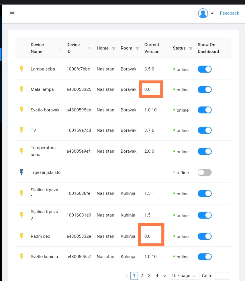

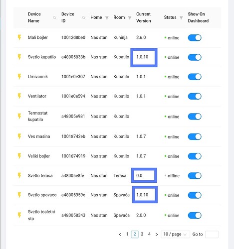

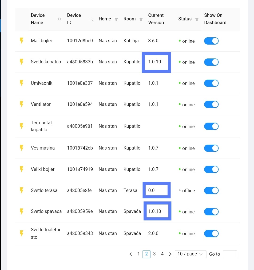

Frimweare ZBMINI L2 markings are marked with a blue rectangle.
As you can see, in two places the firmware is 1.0.10, while in one it is 0.0, why?

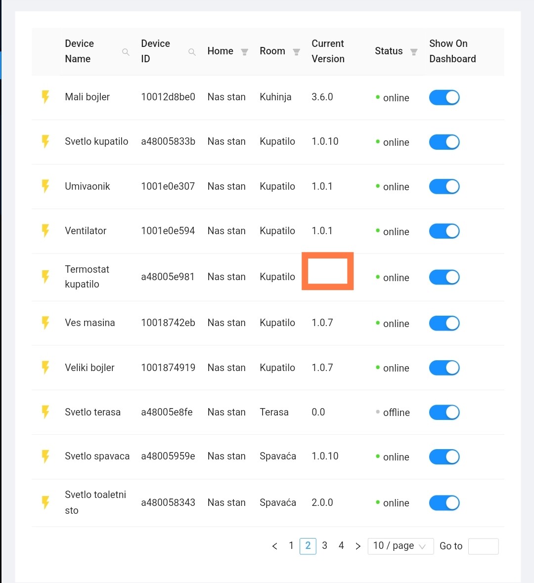

Frimweare ZBMINIR2 markings are marked with an orange rectangle.
Why is the firmware label 0.0?

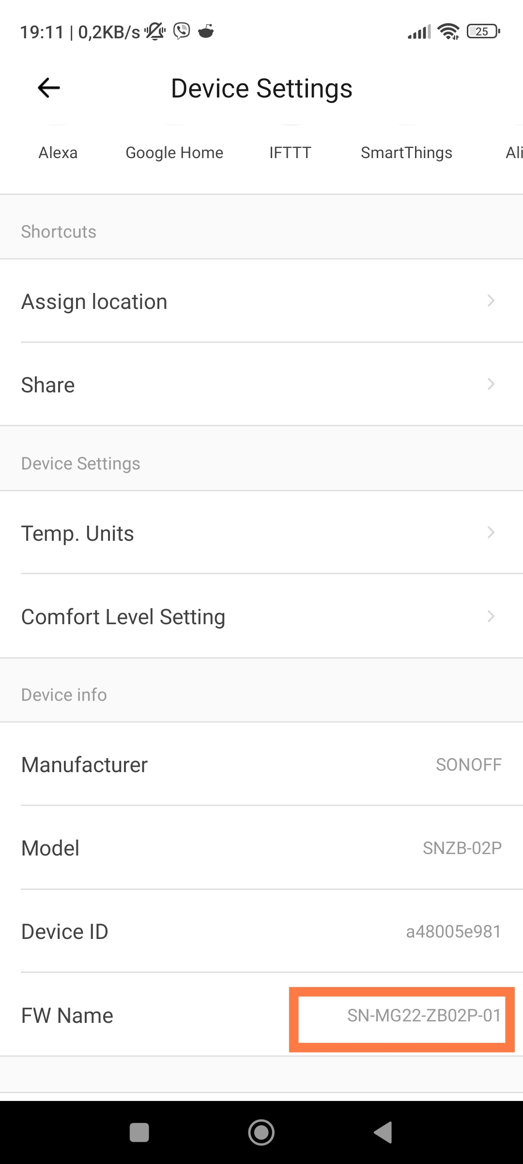

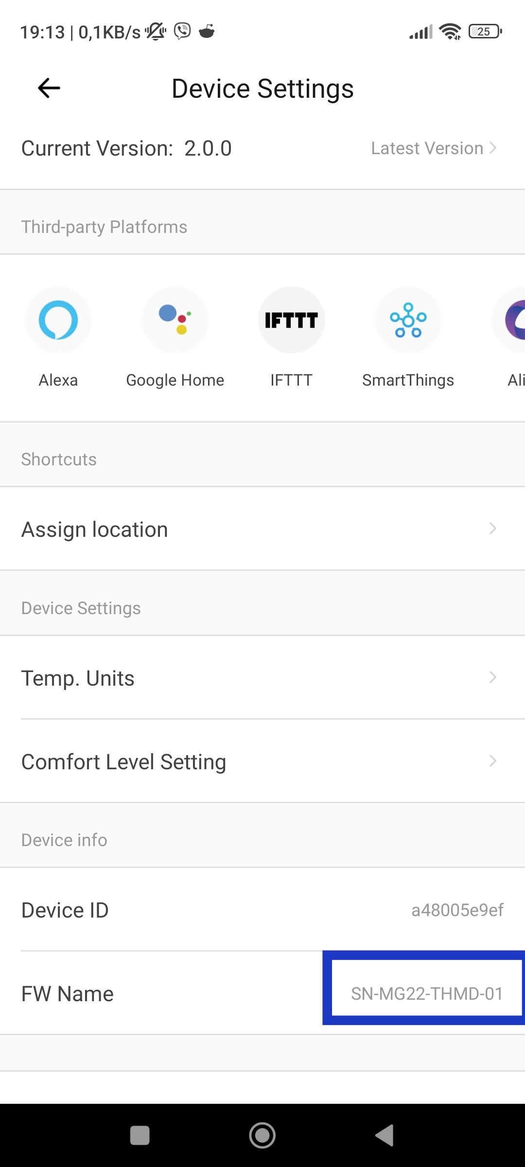

Why is the frimweare label on the SNZB-2P 2.0 in one place and empty in the other?
I note that all devices were purchased together from the same seller and put into operation on the same day!
I think it is necessary to harmonize the frimweare versions!
In the first sccreenshot the device with firmwar 0.0 is marked as offline

This screens is provided by https://web.ewelink.cc.

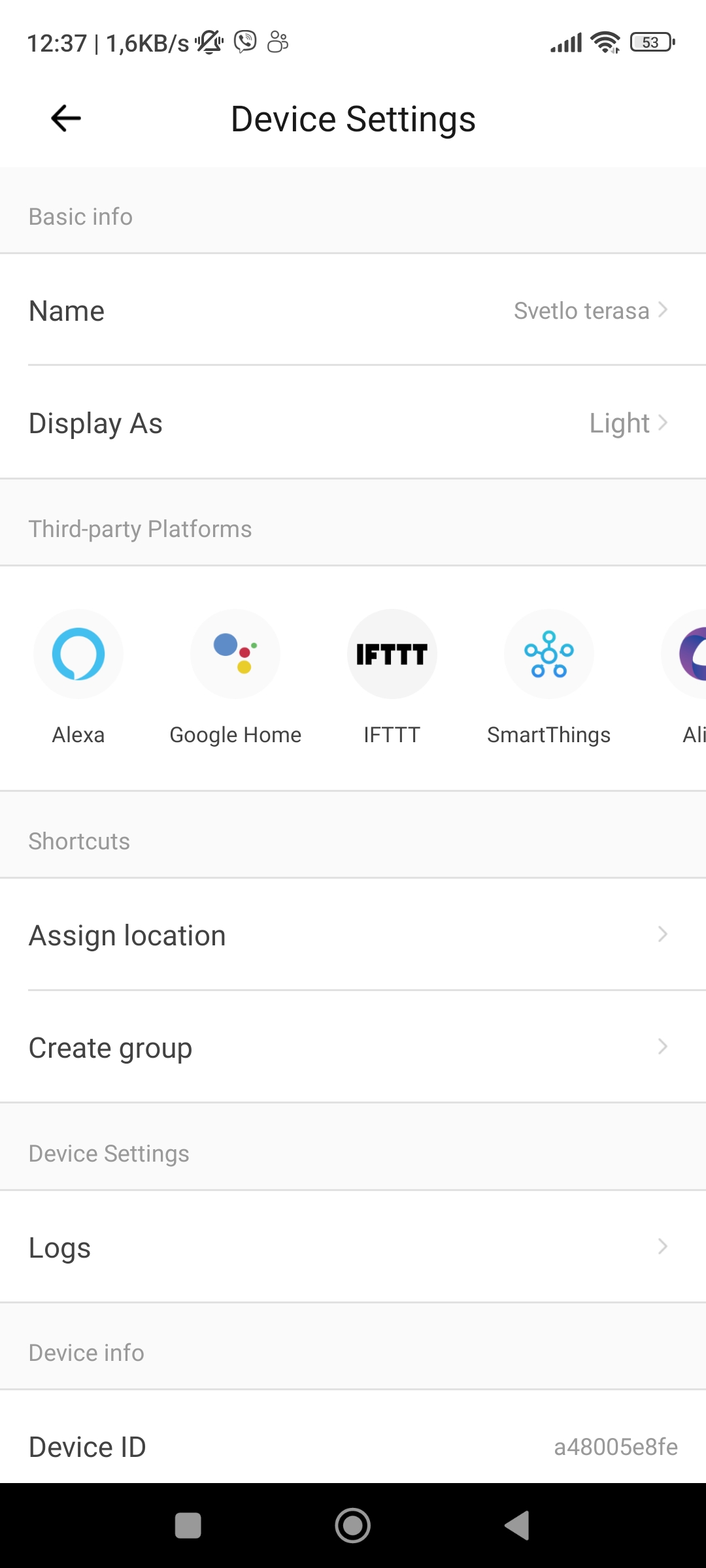

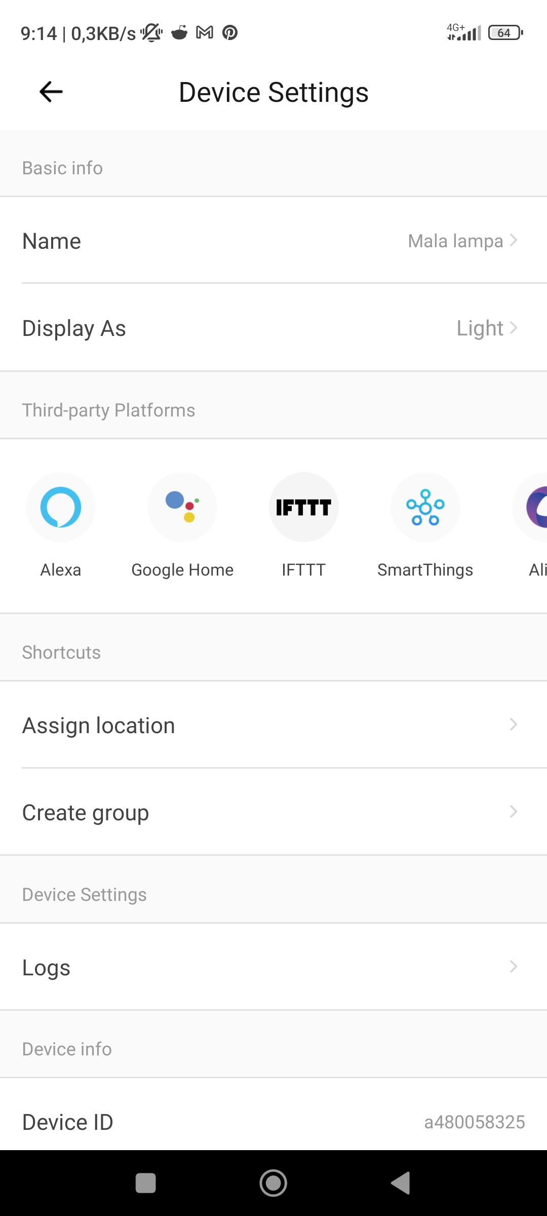

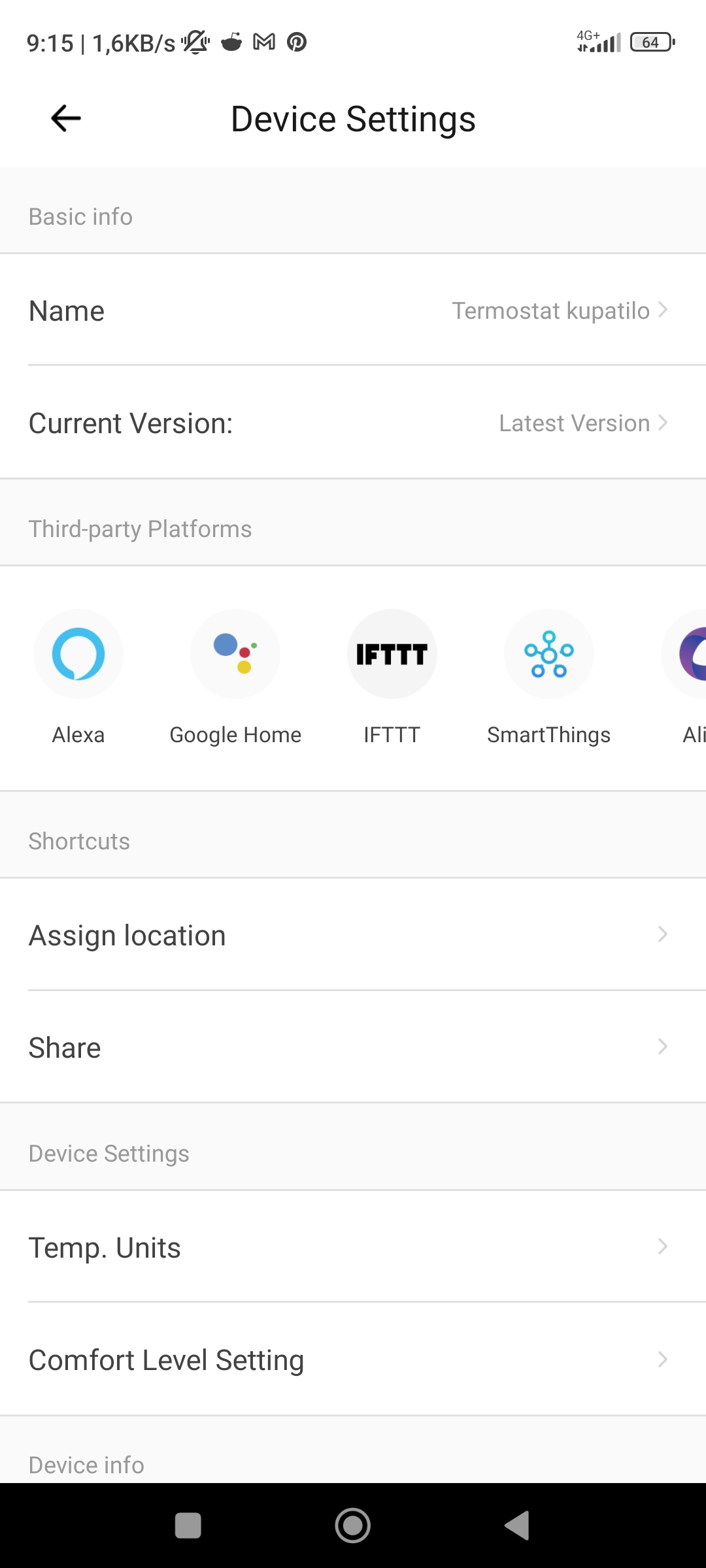

The firmware for Sonoff ZBMiniR2 is not displayed in the eWeLink application
While for the Sonoff SNZB-2P, but only for one device, it does not return the firmware version
Also, the eWeLink application for ZBMini L-2 does not provide any firmware information

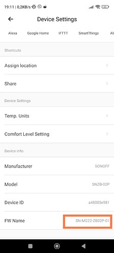

On the SNZB-2P where the firmware label is in the blue rectangle, the eWeLink application and eWeLink Web see the firmware label without any problems
While the SNZB-2P, where the firmware label is marked with an orange rectangle, the eWeLink application and eWeLink Web do not see the firmware label
