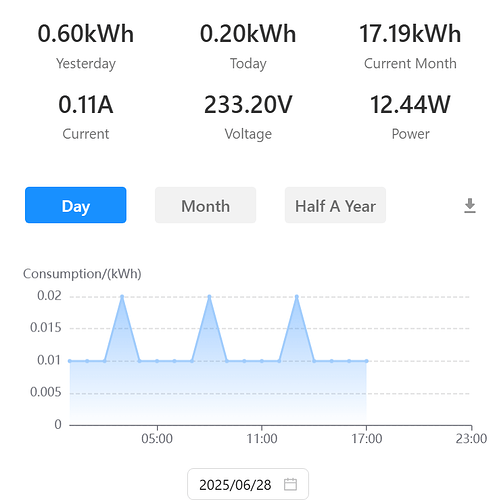

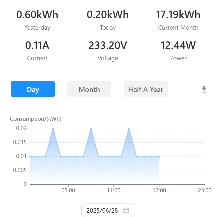

This is what my S60 (FW: 1.2.0) shows. It’s only TV, Blu-ray player and some phone chargers. All non-resistive loads and exceptionally low power consumption in standby. Unfortunately, the manual says nothing about the minimal power load.
12,44W - this is about to be right. What do you expect? What are these peaks related to?
Actually, don’t know what produces every 4 hours such a spike. Maybe, the TV looks for updates…
I doubt it. Must be something else. Try disconnecting devices one by one for several hours and see if peaks are gone. These peaks in regular intervals are rather unusual and there must be some reason.

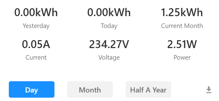

This is the smallest load at which something is displayed. It’s a phone charger with 6 SMD-LEDs.
