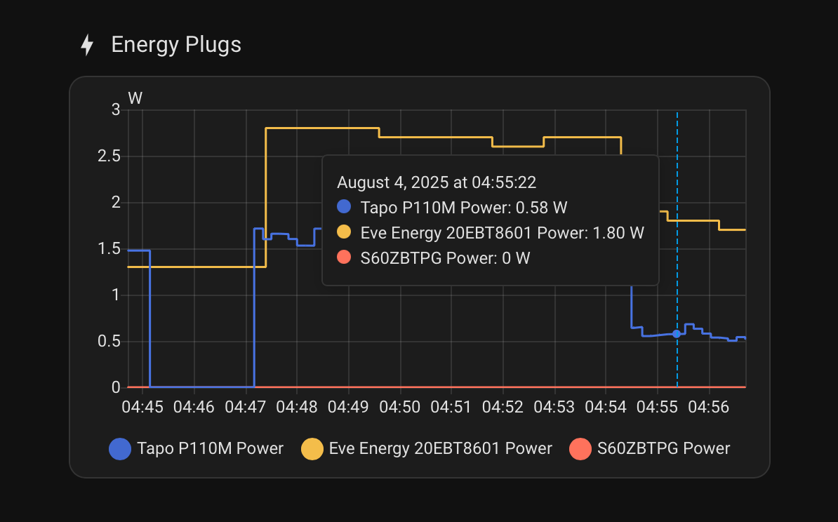

That would be correct… I also noticed the S60’s reaction around 2.5W, but the lower the value, the zero reaction. ![]()

2W IKEA MITLED is shown as 0W… whaht is the minimum power shown by S60?
2W should be detected

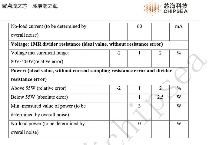

S60 wear the cheapest/worst power meter chip? I can not understand why can not measure under 3W… Today many led lights are under 3W. I thought digital power meters could sense power in 1-3W…
Just got here. I just changed Tapo P110 Power devices for Sonoff S60PTG to simplify my HA installation. I now find the S60’s are virtually useless since they dont consistently report on energy. I wanted to use HA to combine energy values (say to determine usage in the Living Room, or external devices but 4, 5 or even 6 times no reading is still no reading. Has anyone received a reply which indicates Sonoff will address this issue ?

Nope. This is probably a hardware limitation of the device itself, as discussed above. ![]()
