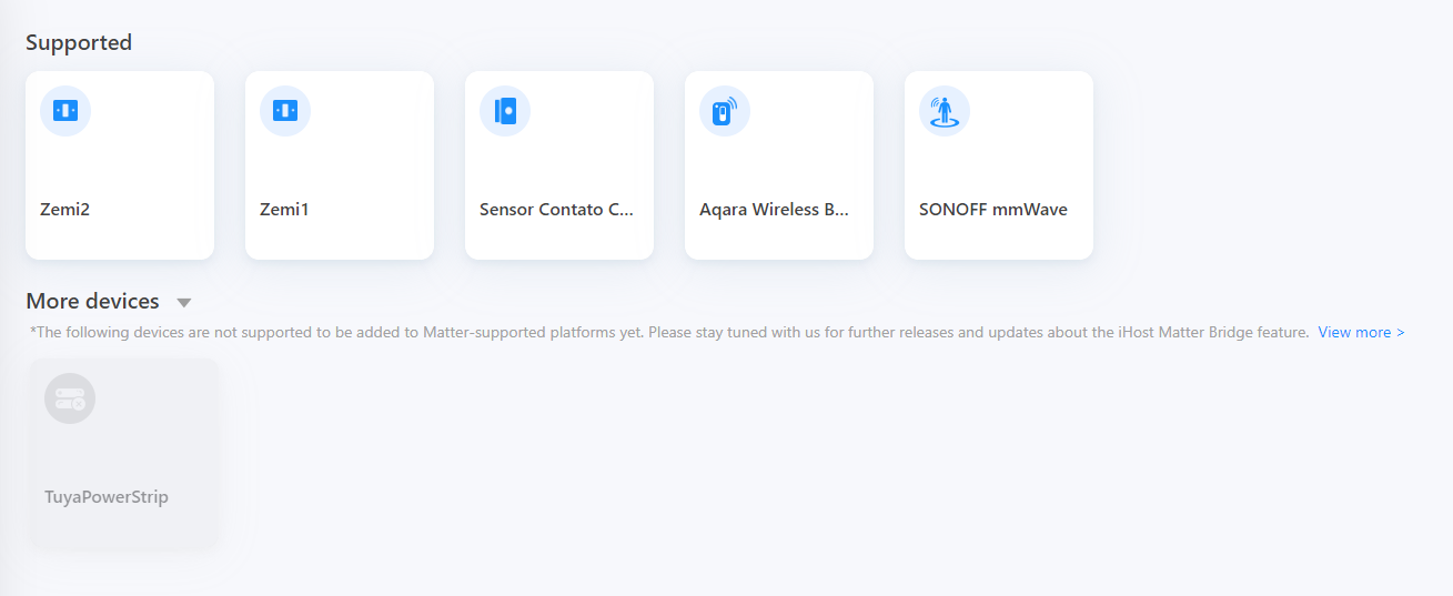

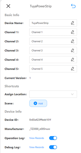

Quick question, do we have any roadmap or news regarding new types of devices being added to the Matter Bridge? I have a 5 channel plug which is not showing as a compatible device in iHost (I believe the current max for iHost is 4 channels), are there any plans to add support to it?
This is the PowerStrip that I have connected via Zigbee2Cube. (AliExpress link: https://pt.aliexpress.com/item/1005005530724136.html)
It’s listed under “More devices”
They do, indeed, but it looks like mission impossible so far. Perhaps this is an affliction of Matter and they cannot do anything about it themselves. We shall live and see. Work and tests are ongoing.
