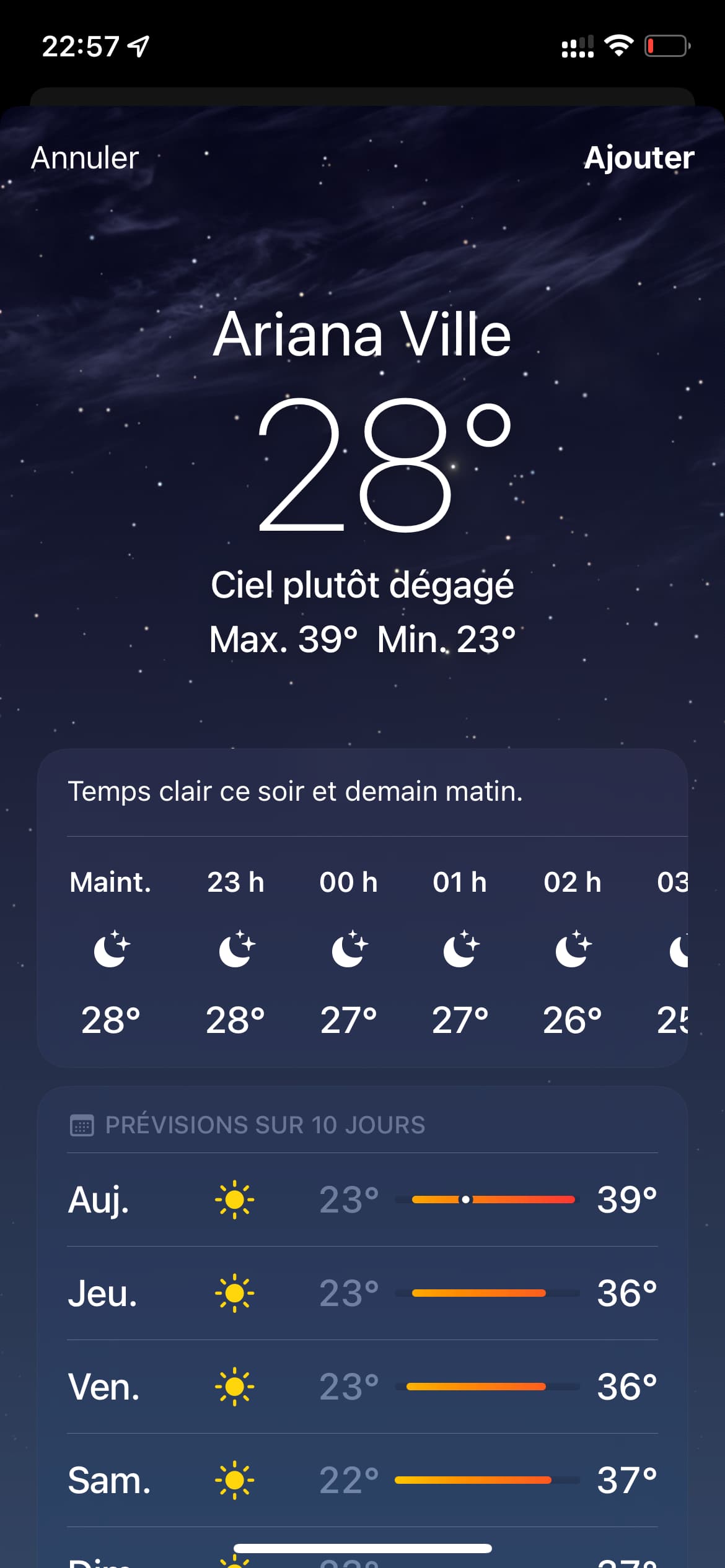

So My problem with the NSPanel is the external temperature (Not the internal temp)
The NSPanel display a wrong temp compare to the real conditions (for exemple when the current conditions are 35°C the NSPanel display 26°C)
I have verified the location, I have reset the NSPanel, I have update the last firmware version but the problem is always here
I just noted that as if it displays a time-lagged temperature (in the afternoon when current conditions are 25°C for exemple the NSPanel display 35°C)
I will send some screen shots this night

@yitie
The screen shot
Hi there, I think the time-lag of the weather data from Weather info provider caused this difference, the Weather info provider refresh data hourly instead of real time, that’s why you tell the difference between NSpanel and the phone.
We will go deeper to see how to optimize this offset, maybe work with more Weather service providers or rise the data calling frequency.
