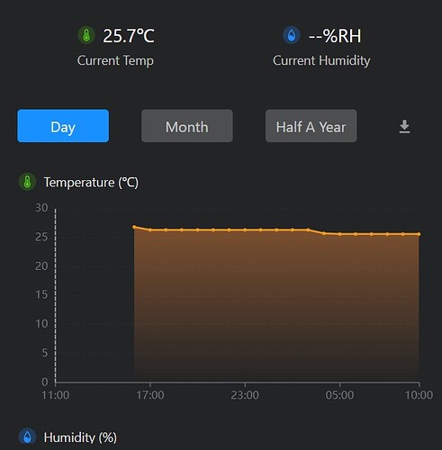

A better option is a later hardware version of the same device on which the sensor is connected by a 3 pin in-line plug not the 3.5mm trs plug on the earlier version. The later version offers LAN operation and also a temperature graph using the eWeLink phone app.
THANK YOU VERY MUCH. I needed the manual for clearing RF codes. I do not have Ihost, so, I think I can use this device without problem, but it does not have LAN control, but I have some probes with 3.5mm jack purchased as spare…
temperature graph is avaible in this device
Do you know why not updates avaible?
Thanks- I will have to look again on the eWeLink App at my New Smart TH-16 to see the graph. I don’t know why there hasn’t been a firmware update to include LAN working but may be because it’s not a Sonoff device. I have one of the later versions (Firmware ver shows as1.2.0 on the eWeLink app but as ver 1.0.0 on iHost with CoolKit as the manufacturer) that does have LAN working and I had thought about copying the firmware from it onto the older ver 3.5.0 device. Internally they both look very similar except for the probe connector but they do not have any connection pads for reading/ writing the firmware. Despite their shortcomings they are a reasonable device if used within their limitations.
