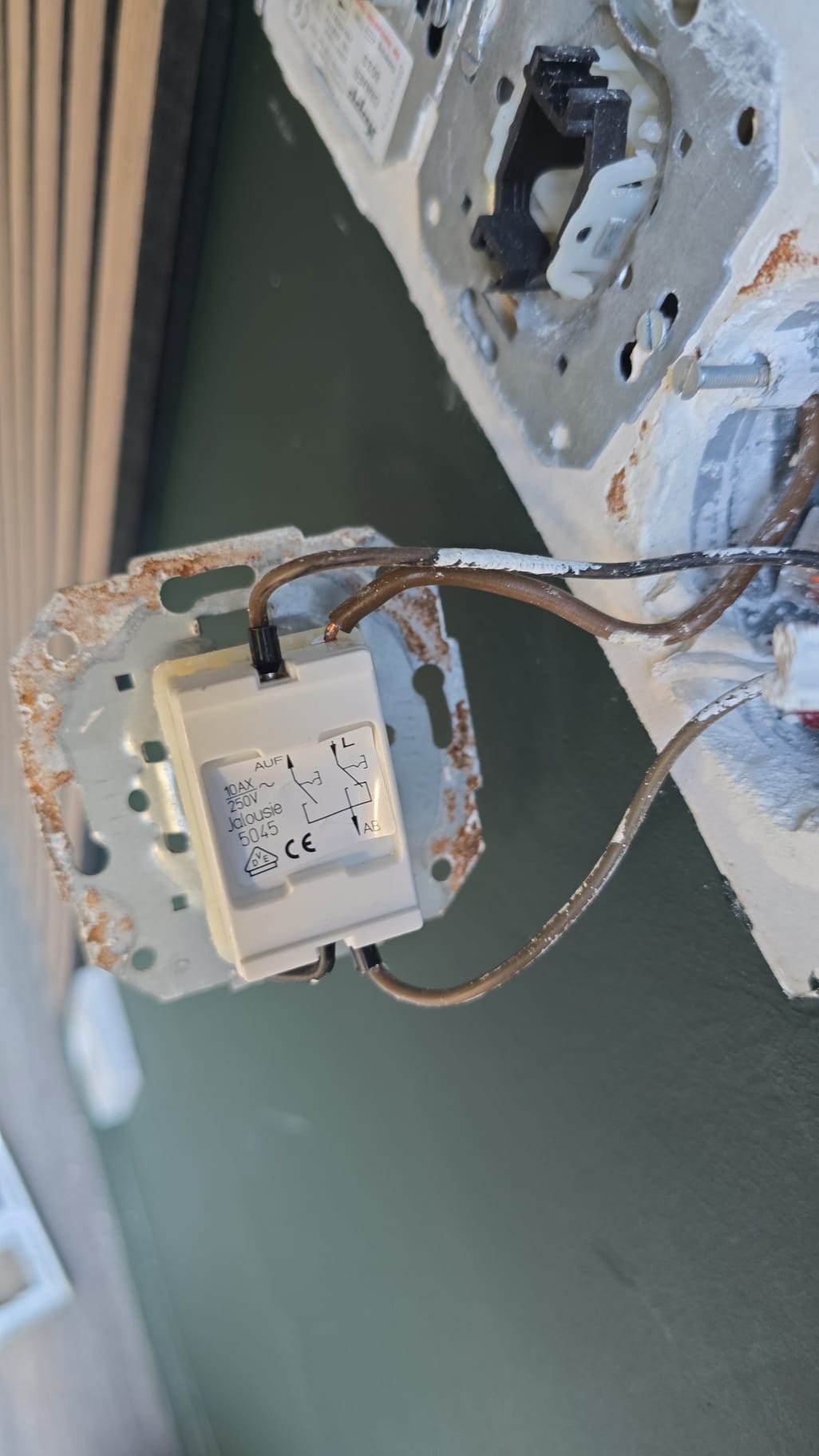

This was the old switch:

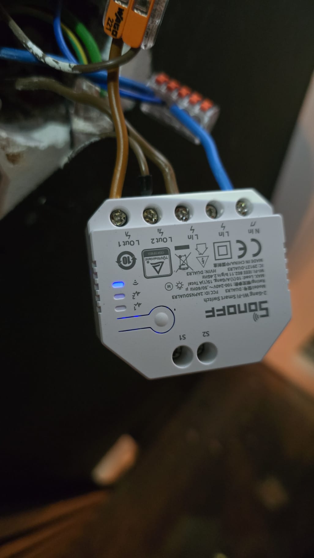

I removed it and connected it like this to the Dual R3:
Here it is doing the calibration automatically:
It stopped there, this was the 3rd time calibrating.
1st and 2nd time calibrating it went well and went back to the starting position.
Problem is: Every time after calibration it will not work in the app.
I tried 3 way rocker switch and 2 way switch, but stay irresponsive.
I should be on the last firmware according to the app.
Is there any solution?
Thanks in advance!
