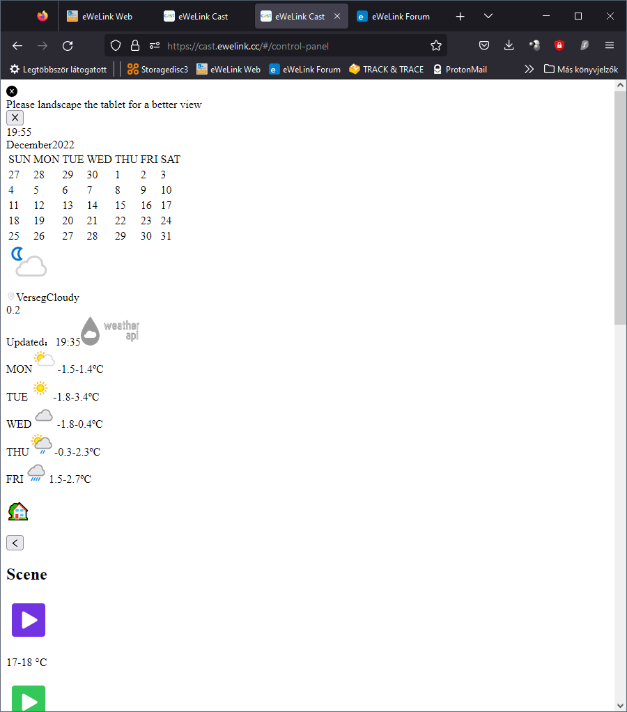

Some CSS problem?
Did you check the internet connection? what about opening other websites?
please help to capture some logs refer to this: Finding Your Browser's Developer Console | Balsamiq
in your screenshot the version is 1.4.2 , while the latest version is 1.4.3 , please try to refresh (shift+F5) or try another web broswer to re-login
