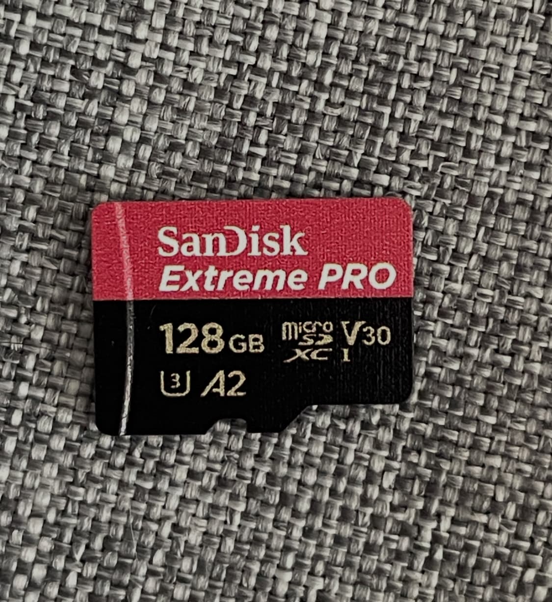

@MichaelLearnsToCode and yes after I received the SanDisk TF and after hours of waiting and third attempt to restart iHost finally started

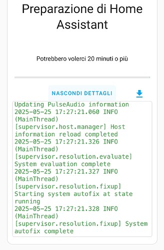

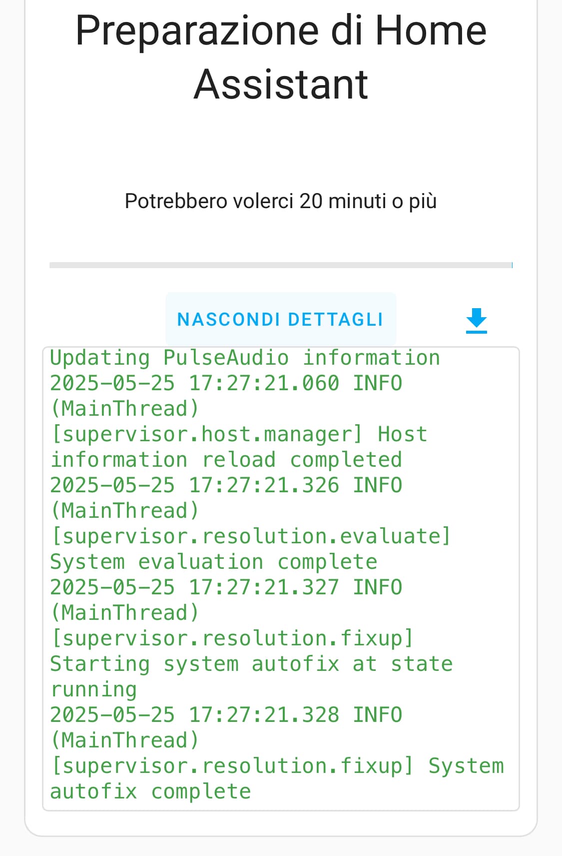

@imassig @alyusuph were talking about the initial installation time of Home Assistant OS and you were talking about the OS startup time.
Regarding to installation time, Home Assistant team themselves state This may take 20 minutes or more. However, many users experienced much more time than 20 minutes. This doesn’t mean there is something wrong with HA or with users, it only shows the installation process performs differently in different situations.

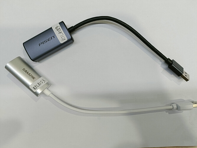

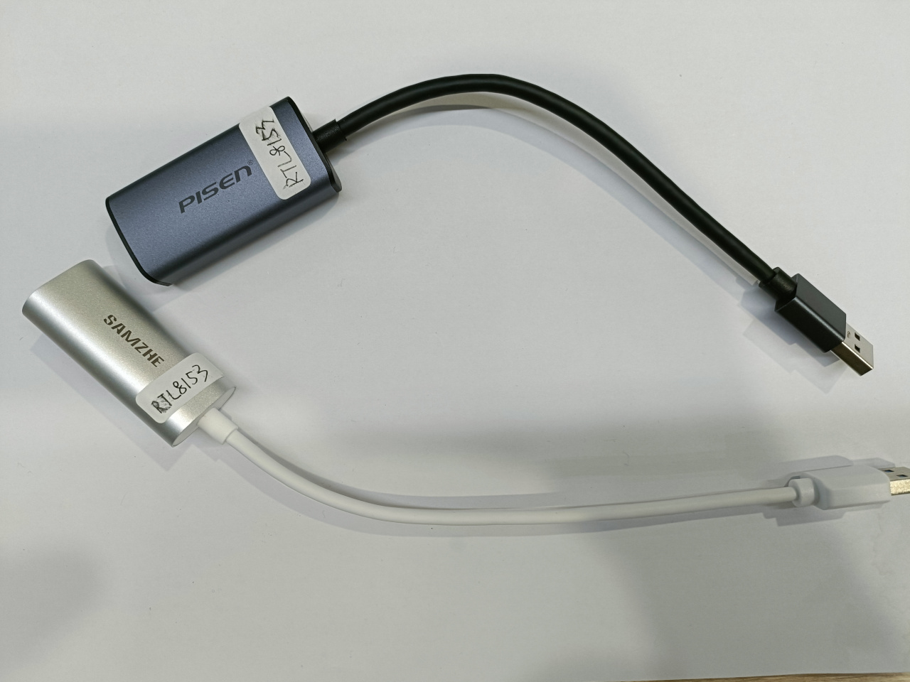

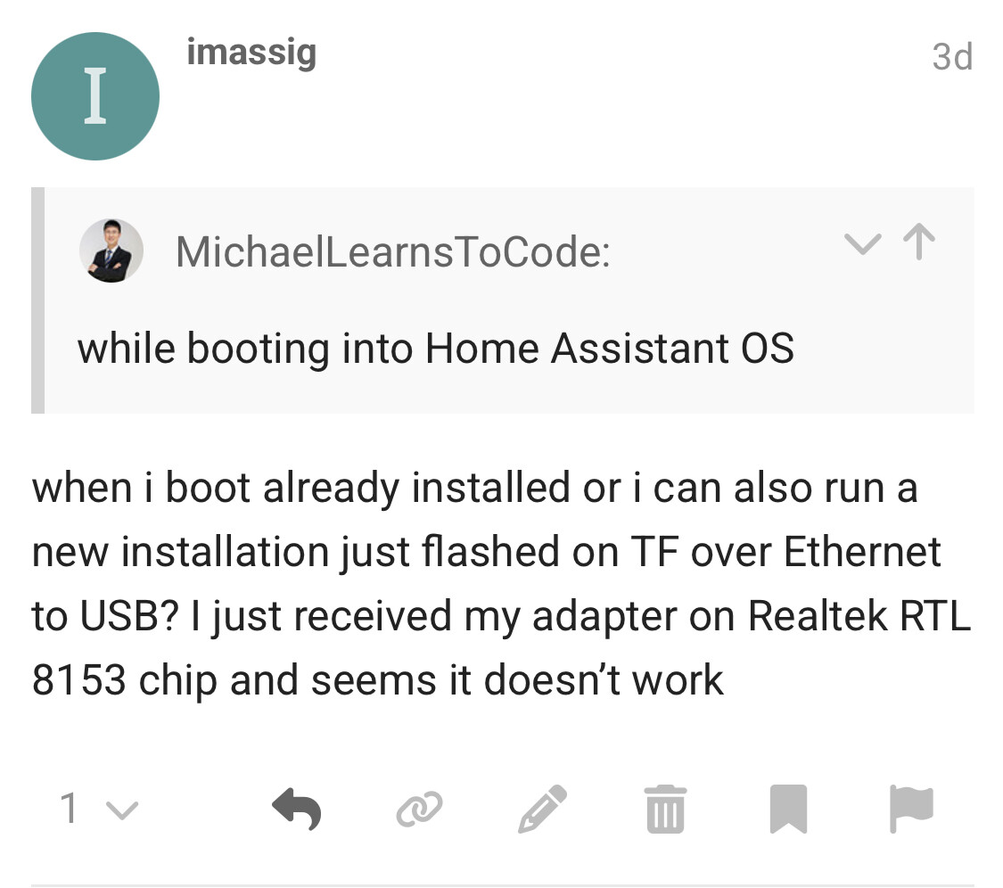

I have also bought and tested 2 additional USB to Ethernet Adapters using RTL8153 chip, and they all works on HA over iHost. I believe you already know it :smiley:
yes mine is RTL 8153 I wrote it on
a post above

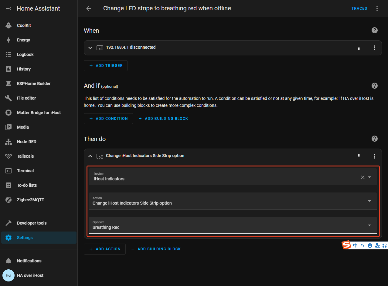

Can you please update the ihost hardware control add-on entities to show exactly the behaviour of the side LED bar, insteaf of showing option one, two ot three?
For example if one wants the side led bar to brearh red colour by selecting an entity that states red colour if there is a persistent notification instead of current entity options requiring selecting option one or option two etc.

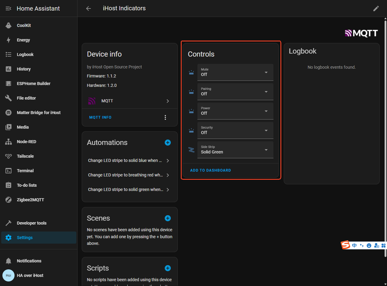

I am sorry I don’t quite understand which GUI component you are talking about.

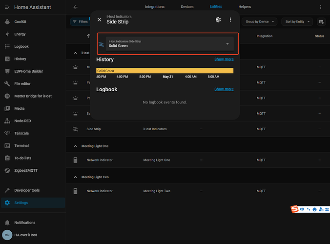

If you look at side LED stripe in Entities view, it should look like this:
If you look at side LED stripe in Device view, it should look like this:
If you look at side LED stripe in Automations, it should look like this:
Could you take a screenshot of the side LED stripe UI which you think is inappropriate.
By the way, please make sure you are using the latest version which is 1.1.2 of iHost Hardware Control add-on.
I am using the latest version and have applied a toggle switch for automatic updates.

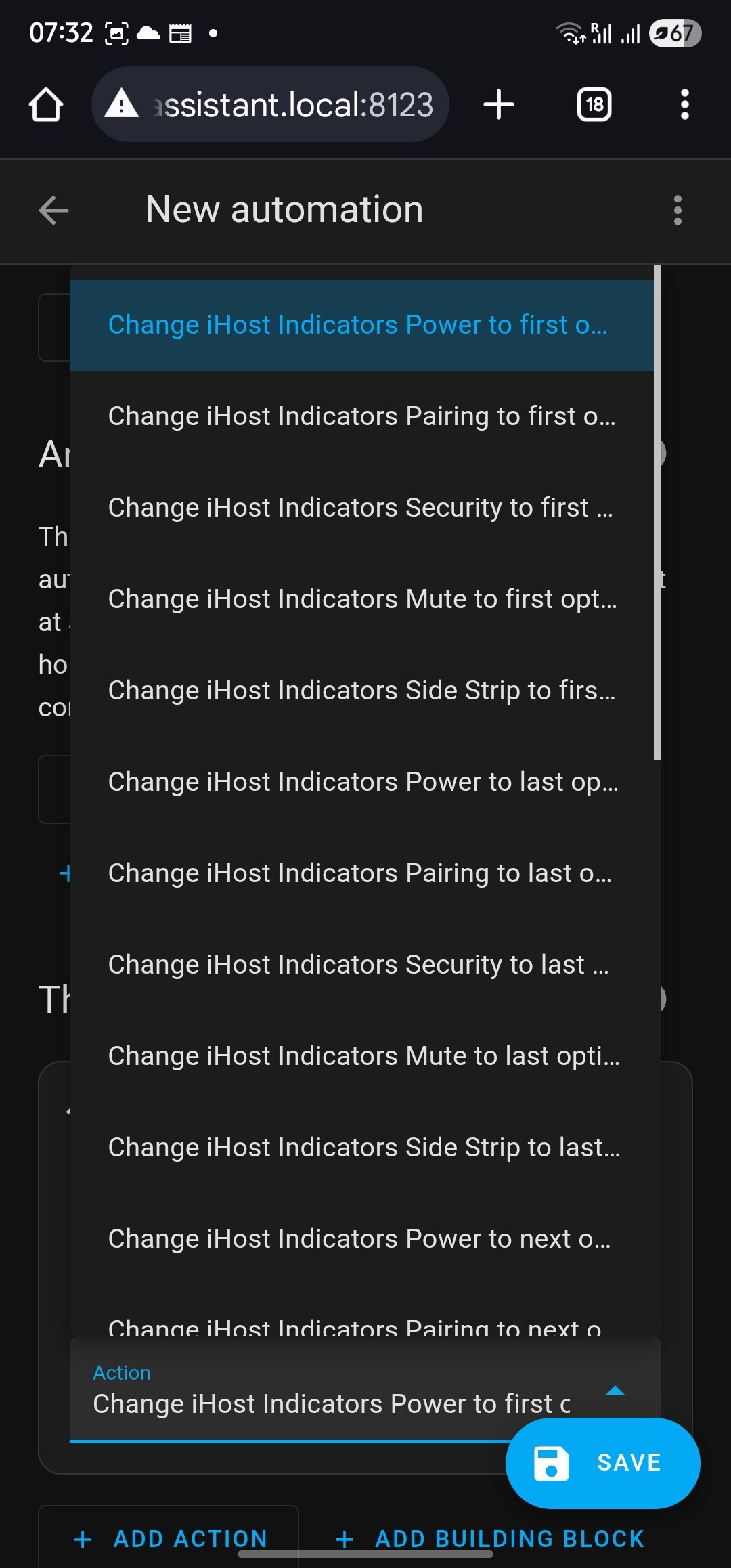

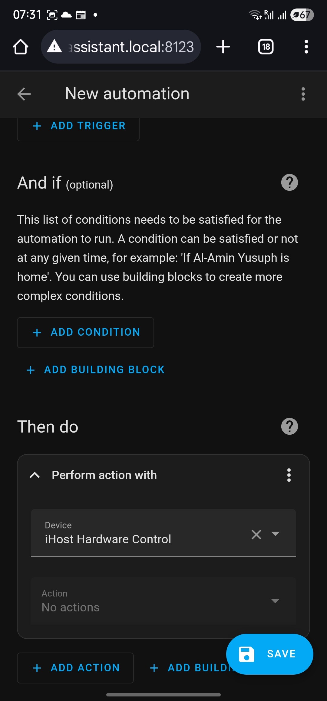

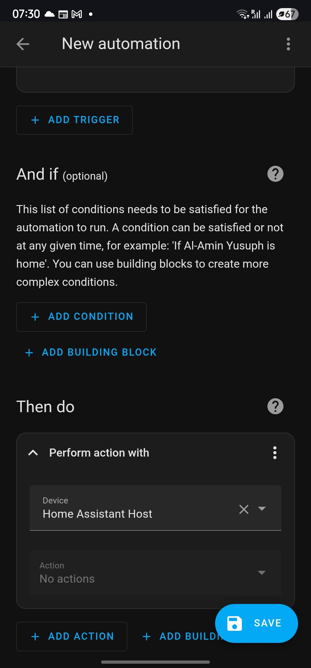

If you access the entities through HA. Try to create a new automation that will change the side strip colour and you will notice theconfusion.
There are even.no actions associated to Sonoff Ihost entity and Sonoff Hardware control entity.
Sorry for the confusion, you were looking at the wrong entity.
Home Assistant Host is the entity provided by Home Assistant OS, and iHost Hardware Control is the entity also provided by Home Assistant OS when iHost Hardware Control Add-on is installed. We as add-on developers can do nothing about it.
For the real devices and entities exposed by iHost Hardware Control Add-on (through MQTT), you should use:
  • iHost Buttons device (in MQTT integration) with following entities:
    • Mute
    • Pairing
    • Power
    • Reset
    • Security
  • iHost Indicators device (also in MQTT integration) with following entities:
    • Mute
    • Pairing
    • Power
    • Security
    • Side Strip
  • iHost Hardware Control Automations (device also in MQTT integration) with following events:
    • “Home Assistant” is started
Seems this does not apply to.me as I am using ZHA. No problem, I will live with the shortcomings
Oh, it has nothing to do with ZHA or Zigbee2MQTT.
When you install iHost Hardware Control Add-on, it will automatically install Mosquitto broker Add-on, and alert you that HA has discovered MQTT devices in Settings -> Devices & services -> Integrations. You can click the ADD button of MQTT integration card, and then you’ll get the iHost build-in devices and entities I mentioned earlier.
Give it a try please, it’s easy and useful :smiley:

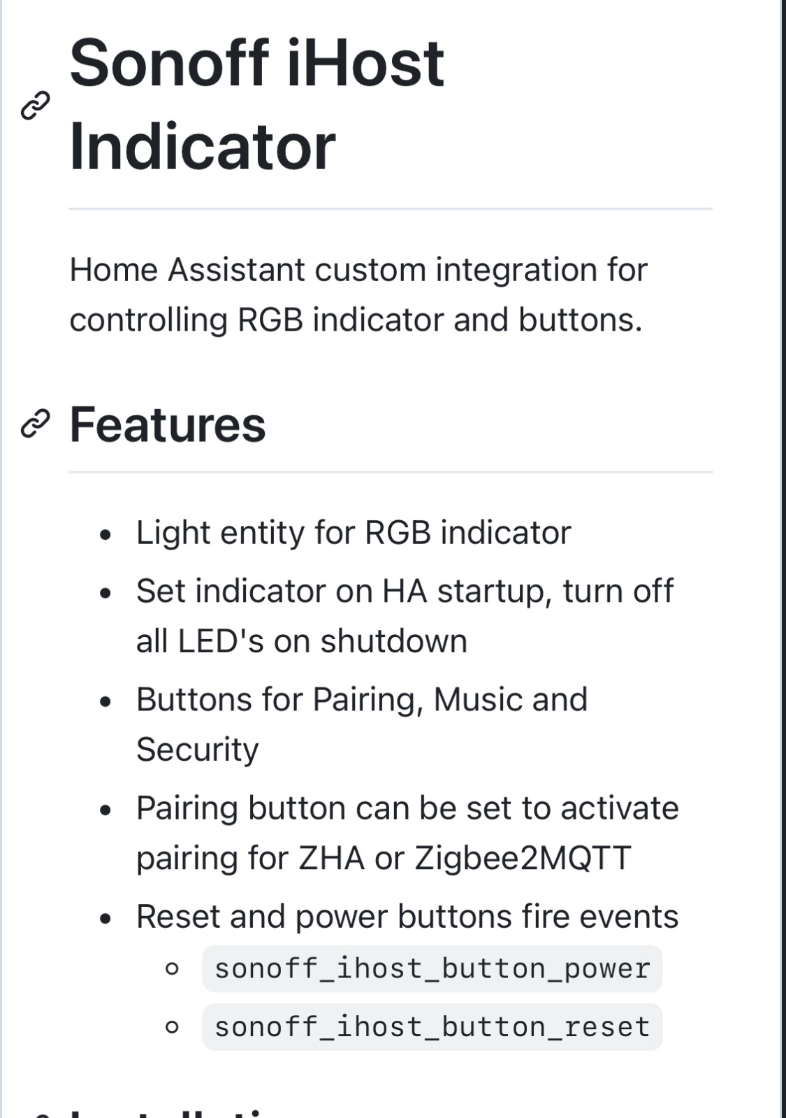

what I would like for me Side Strip brightness that I can’t find. Thanks
The current version of iHost doesn’t support brightness control of LED indicators. I am sorry for that.
The issue is not to access the entities through the MQTT Card. I already access them and I can I.can change tge different configuration through the MQTT Card, .The issue is to have them wotk through.HA automations as I wish.
I use that one and it works also side strip brightness level, I wanted you to integrate it into your official addon
