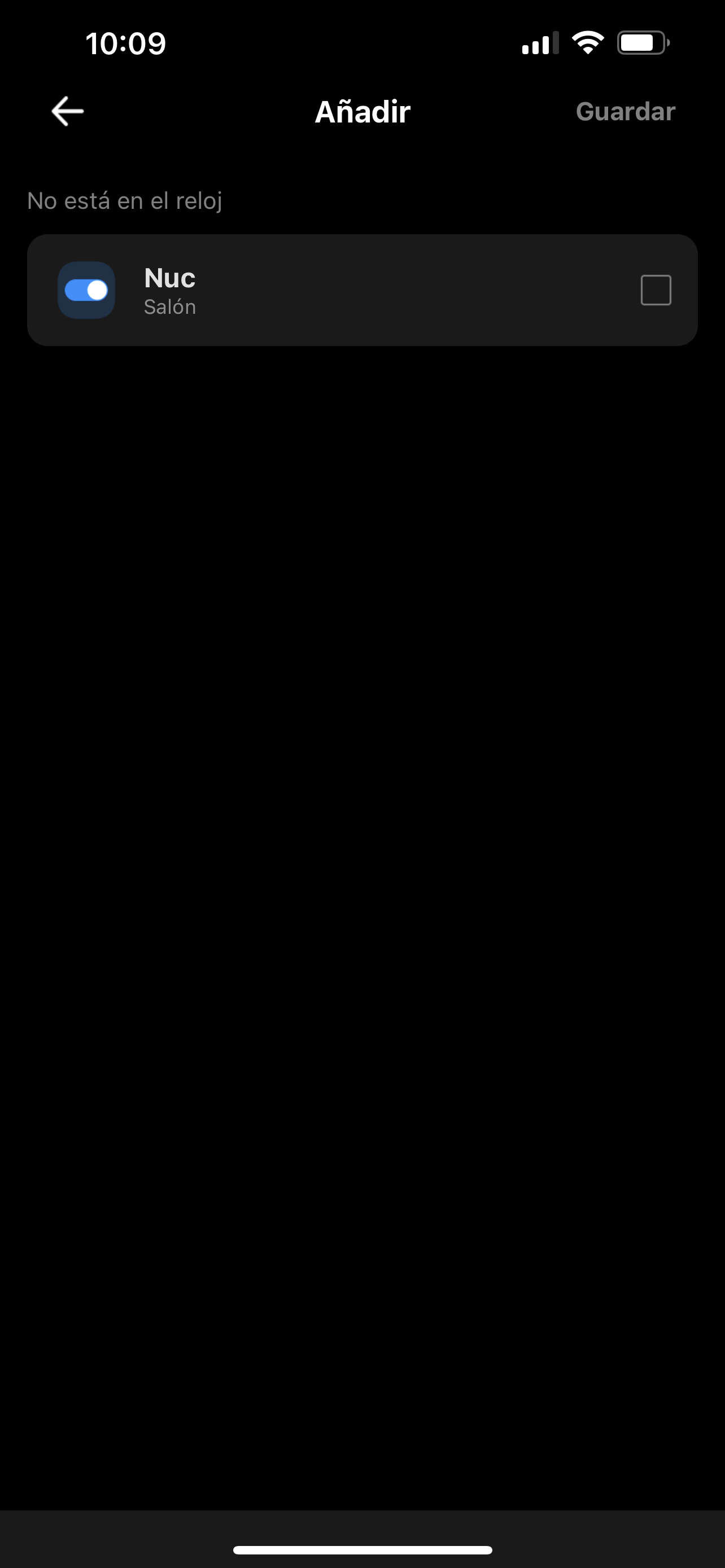

All connected to the ZBBridge-U no zigbee device appears in the list to add to the Apple Watch, only the wifi devices remain.
I even have the temperature wifi and it appears in the list but it doesn’t show the temperature, as it is wifi it lets me add it.
As you can see in the screenshot, the Nuc is a 5v mini wifi and there are no others to add, the other additions are wifi.
The new zigbee I bought this month should appear here, but no zigbee appears.
