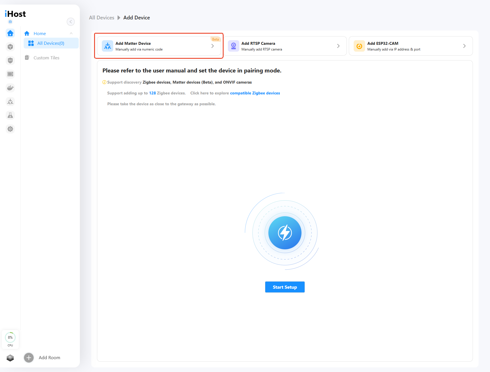

The build-in OS on iHost is eWeLink CUBE OS, and CUBE OS has build-in Matter Hub (Matter Server) and Matter Bridge.
To add Matter devices, please go to Home -> Add Device (top right corner) -> Add Matter Device (Beta)

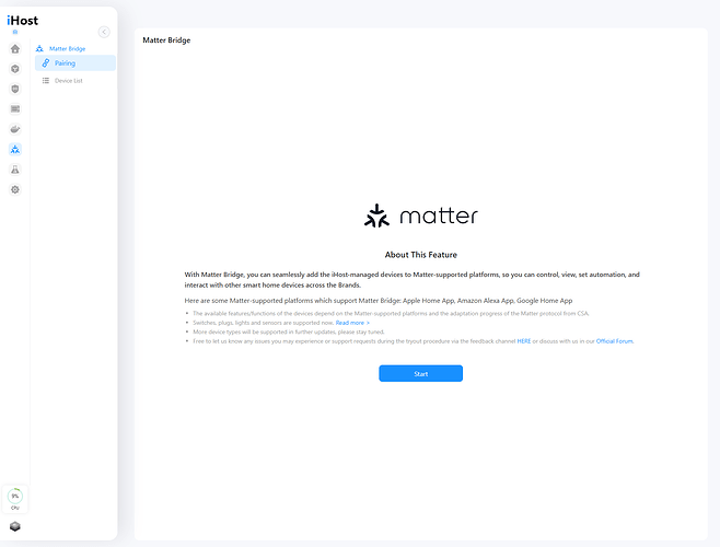

If you want to export devices in eWeLink CUBE OS to other Matter fabric, such as Apple Home, Google Home, etc., you can use CUBE OS’s Matter Bridge feature.
