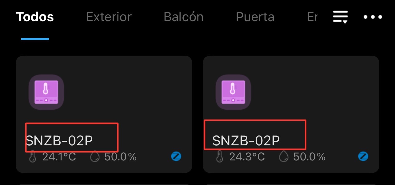

The same thing happened to me after a power cut.
It only resets the name in my case on SNZB-02P devices updated to 2.2.0. All SNZB-02P devices with version 2.1.0 do not change their name.
It must be a bug in the latest ZBBRIDGE-U update or in version 2.2.0 of the SNZB-02P.
I hope they fix it, as I have more than 12 SNZB-02P devices.
