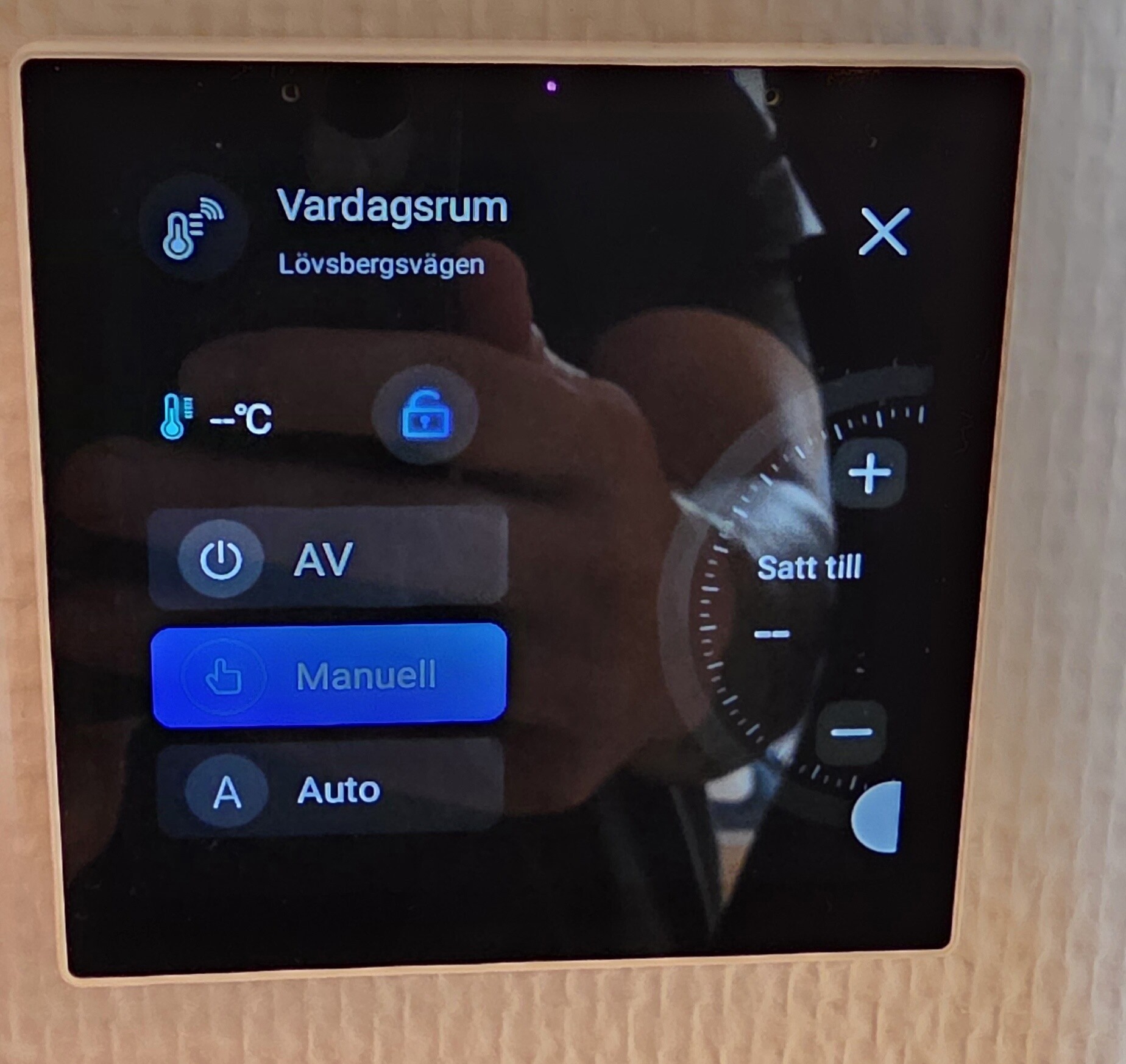

Hi, thank you for your feedback. I’ve conducted a test and confirmed that the issue does exist. However, the display shows “–℃” instead of “0℃”. Could you please provide a screenshot of your device’s display? This will help us confirm that the issue we’re fixing is the same one you’re experiencing. Thank you again for your cooperation.

Yes, you are right, it’s “–”, see picture.

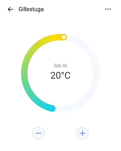

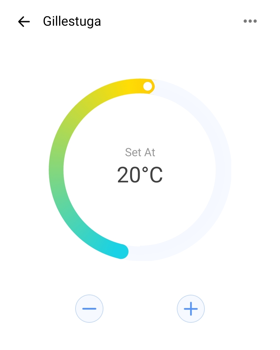

Just to be clear; I don’t expect to be able to read the temperature of a group, but it would be nice to be able to read the temp setting, to be consistent with eWeLink app
