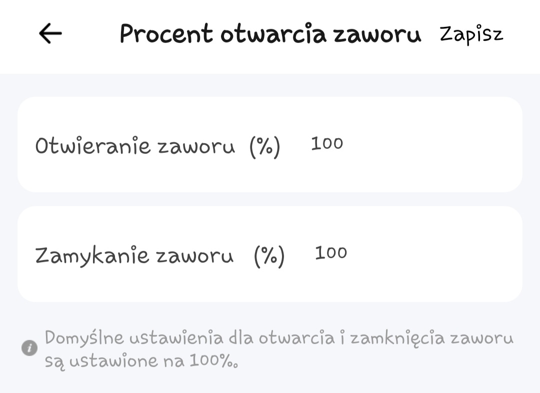

I just have bought and installed my first TRVZB and find out % valve opening and closing…
Could You please explain what it is for?
I understand for example 60% opening and then full closing after reaching the set value… but what is closing % valve for? How the valve will work when I set open/close on 60% both ? Does it mean the valve will firstly open for 60% but never close because closing is set also on 60% ?
What are the differences between having them both on 60% or 60/30%?
Does it mean that setting 30% close valve will always left this valve open, and the warm/hot water will always flow through the installation?
I have read all instructions available but there is not a single word explanation…

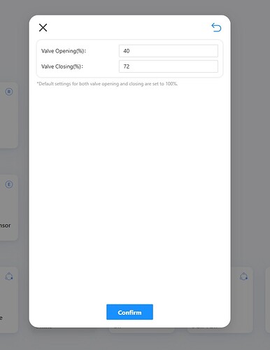

For Valve Closing (%) 100%= Valve Fully Closed, 80%= Valve not fully closed but actually open 20%. You can use this feature for example if the TRVZB is fitted onto a bathroom radiator/ towel rail. If the bathroom is cold the valve will open to the set % when ‘Heating’ but when ‘Keeping’ the valve will only allow a low flow of heating water through the radiator if the boiler is ‘Firing’. This is useful as most boilers have Heating Over Run so that the circulating pump continues for a period of time after the boiler stops ‘Firing’. The slightly open TRVZB will provide a path for the circulating water when in over run condition and reduces strain on the circulating pump.

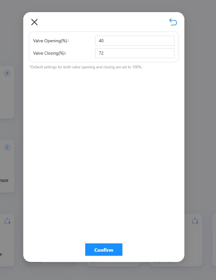

I still don`t get it…
If I set valve open at 50% and close 80% the figures doesn`t add up
In the first time when valve is totally closed and temperature drops below set value, the valve starts opening and goes up to set 50%… temperature raises above set value so the valve starts closing and goes down to 80% … how? If the procentage opening value was only 50% how the valve will close to 80% … will it reach -30% ? :smiley: or maybe there are two separate scales , one for opening and the second for closing? but what for?
Maybe someone will explain to me how the valve will act if open set at 50% and close at 50% ? Does it mean the valve will not act at all?
It does add up but is confusing. Open % is the % measured from the valve fully closed position and the Close % is the % measured from the valve fully open (100%) position. If the open % and close % are both set at 50% the valve will stay open at 50% and not act. So yes you are correct there 2 scales with different datum points. You should also be aware that every Monday at 12 Noon (Local Time) the valve will carry out a Calibration/ De Calcification process where the valve will open and close by 100% regardless of the user open and close settings. In my own system I use the open % to balance the radiators to achieve the 11 deg C difference between the input and output pipes- this means that none of my TRVZBs are set to Open 100% on heating but all except one are set to Close 100% on keeping . The exception is one bathroom that has a valve close value of 72% on keeping so is actually open 28%. It means the radiator will be slightly warm if any other radiator is heating. It is good practice to have a bypass like this on the heating system to allow some flow on circulating pump over run or if the boiler starts up by its own frost protection.
