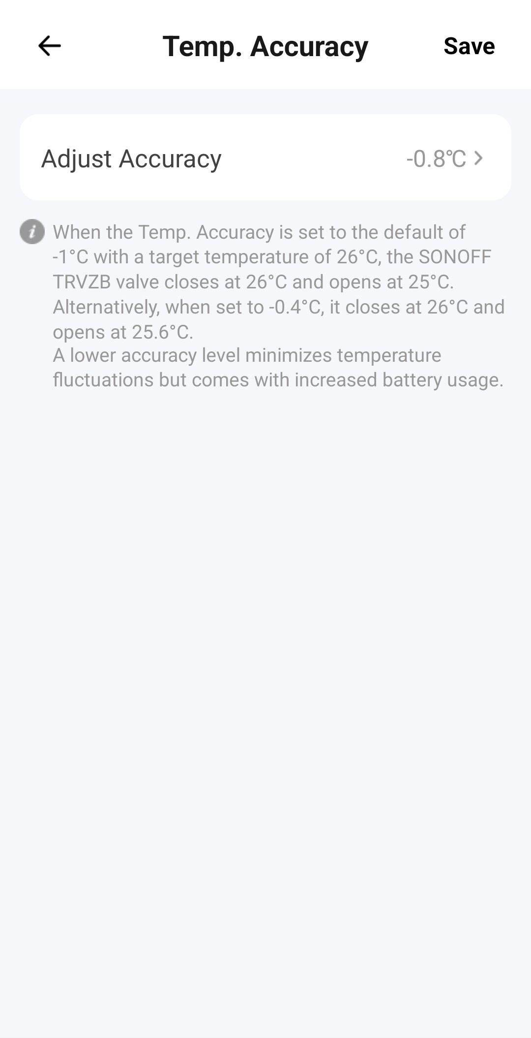

This option is already there, it’s called “Temp. Accuracy”.

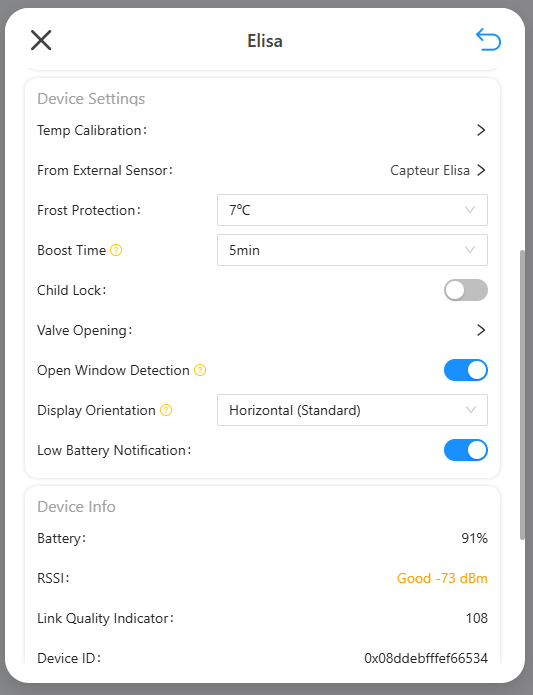

But I have the Ewelink Cube, and it seems that this option doesn’t exist.
And I have the last update of Ewelink cube

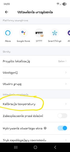

In the last screen you published your first item is “Temperature calibration” I think that’s exactly what you’re looking for
no, it is not the same thing.
I have updated my TRVZB 1.3.0 to 1.4.0 and temperature calibration disapeared :enraged_face:
Hello.
I partially solved this issue in the following way.
I also have a Sonoff ZPBridge-P Zigbee interface with the Ewelink Android app.
So I temporarily paired my TRVZB devices on this interface, then set their trigger threshold to 0.2 °C via the Temp Accuracy menu, and then I re-paired my TRVZB devices on the Ewelink Cube of the I-Host (which does not include this settings menu).
However, it works: the TRVZB devices kept the 0.2 setting.
Of course, this method is not very convenient, and I had to recreate all the scenes, but fortunately this is not a setting that needs to be changed often.
