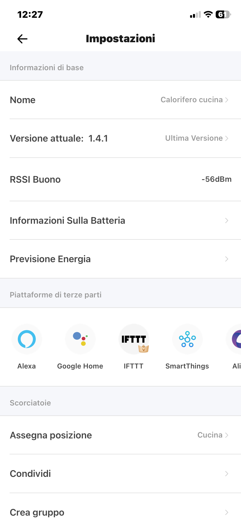

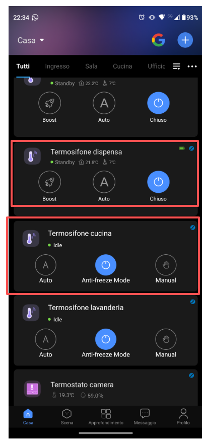

Good morning, I updated to version 1.4.1, but I can’t find the boost mode or the new features when I log into the trvzb, as shown in the images released. Why? Furthermore, only 2 out of 5 valves found the update. Why?

I’m in the same situation, three valves show me the new functions, but all the rest don’t! Anyone know what to do?
