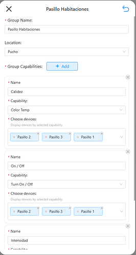

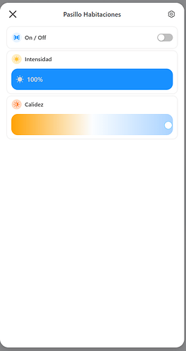

I’ve successfully created a group of these bulbs on the iHost. When I access the group directly, I can control all the lights together. I can adjust the brightness, change the color temperature, and turn the entire group on or off without any problems.

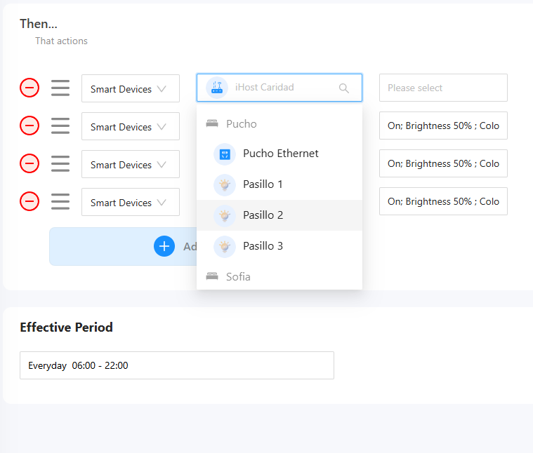

The issue arises when I try to use this group in an automated scene. When I go to create a new scene and select the devices to control, the group I created does not appear in the device list. I can only see and select each individual bulb, not the group as a single entity. This makes it difficult to create a scene that controls all the bulbs together with a single action.

I’ve attached a screenshot showing the group I created and another showing the device list when I try to set up the scene.

I have the same problem.
Sonoff official support replied that it is not possible to select a group as a triggered device for light bulbs, only for switches and some other devices.
This fuctionality is available in tuya smart life, for long time.so maybe you will be better off trying it. Shame on sonoff for their software that works like shit
I think the request is quite reasonable, let check with the team to see if and when it will be supported.
@SuiKa @Jemma @KwayLi99
@auffantre @bohdangutnyk Check with the dev-team, this feature- groups control in scenes - is on the to-do list, need time to set a dev-version and make it happen, please stay tuned.
